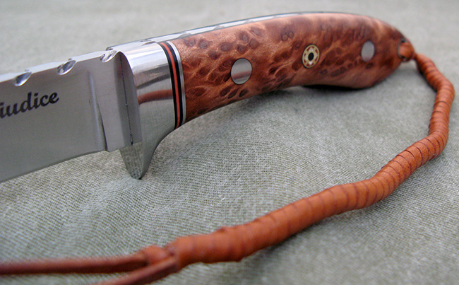

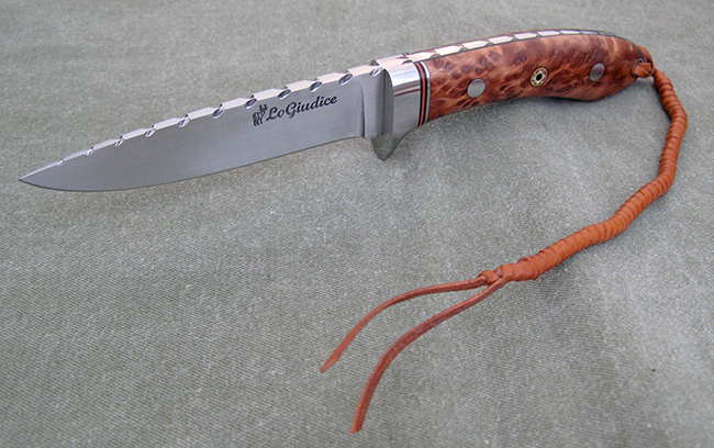

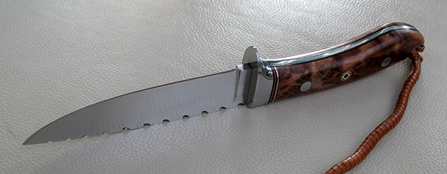

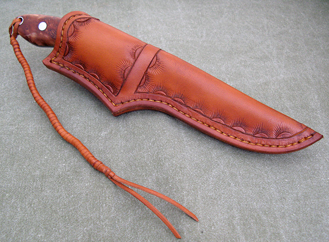

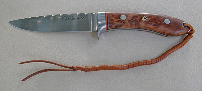

Here's a hunting knife and sheath that I completed recently. Designed for skinning and boning. Comments and recommendations welcomed.
Type:
Narrow Blade Drop Point Utility Hunter​
Overall length:
8-1/4 inches​
Blade length:
4-1/16 inches​
Blade steel:
Hand ground CPM 154 stainless steel, 800 grit hand rubbed finish​
Blade hardness:
62 Rc.​
Tang Thickness:
0.175", Tapered​
Heat Treat:
Peter's Heat Treat​

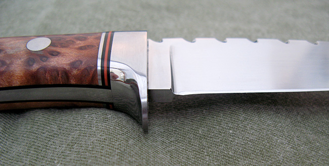

Grind type:
Flat​
Handle material:
Redwood burl wood​
Handle spacer:
Black vulcanized fiber​
Guard material:
Hand shaped 410 stainless steel, pinned & soldered​
Guard spacers:
Black & Brick Red vulcanized fiber with 416 stainless steel​
Fasteners:
Stainless steel corby bolts, mosaic pin by Lane Reed, stainless steel lanyard tube​
Lanyard:
Braided kangaroo skin lace, tan​

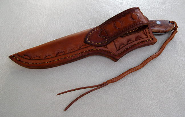

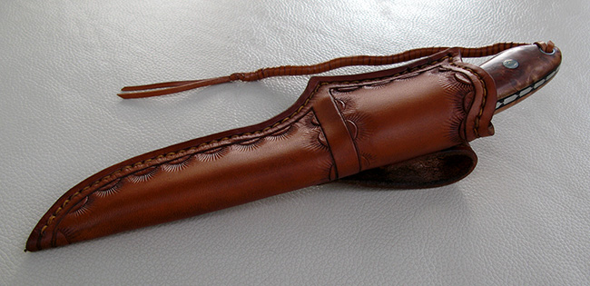

Sheath:
Hand tooled and stitched pouch sheath by Michael LoGiudice with border tooling. Dyed saddle tan with brown antique highlighting, sealed.​
Thanks for looking.
