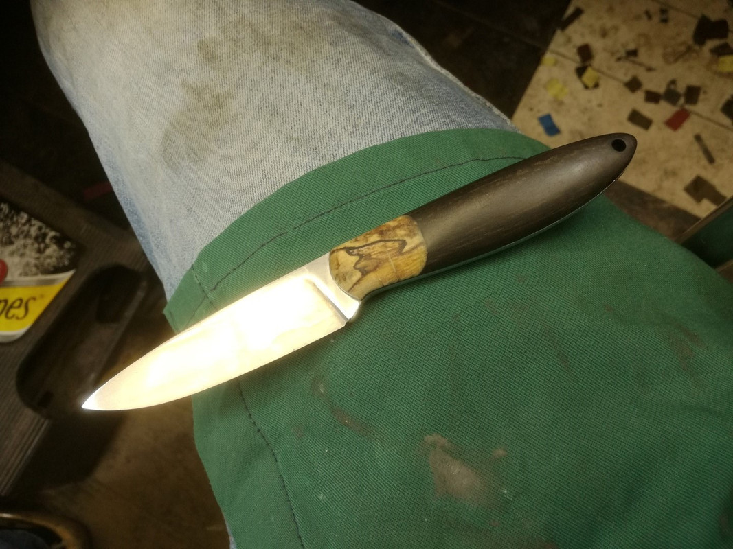

I make these 3,5" user knives.
They are 23mm wide, an inch is 25,4mm.
Very handy knives/EDC.
I make them with an inside front pocket sheath.
