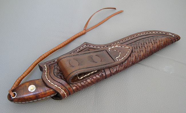

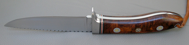

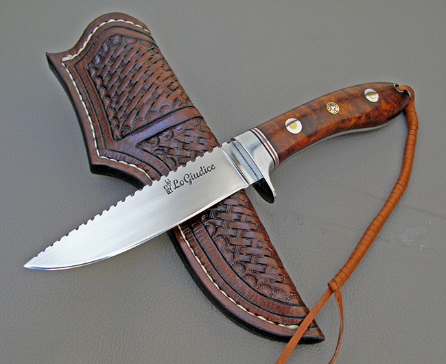

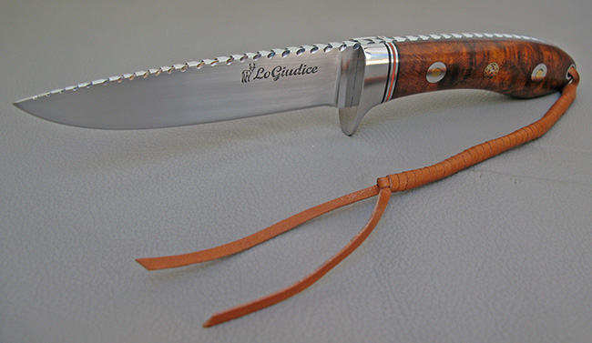

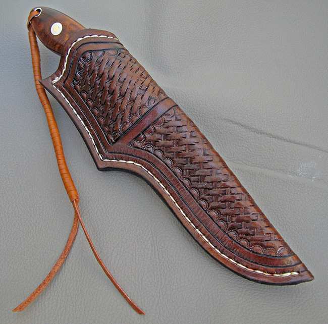

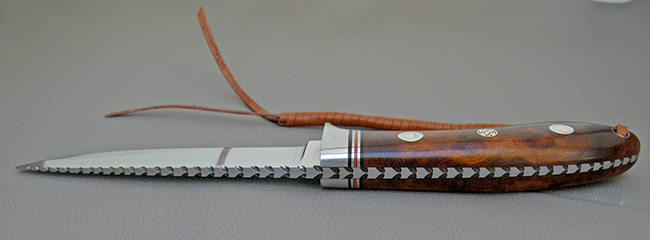

Here's a hunter that I delivered to a customer this weekend.
Specifications
Type:
Drop Point Utility Hunter​
Overall length:
8-1/4 inches​
Blade length:
4-1/8 inches​
Blade steel:
Hand ground CPM S35VN stainless steel, flat grind, 800 grit hand rubbed finish, tapered tang​
Heat Treat:
Peter's Heat Treat​
Grind type:
Flat, tapered tang​
Handle material:
Desert Ironwood​
Guard material:
Hand shaped 416 stainless steel, pinned & soldered​
Guard spacers:
Layers of 416 stainless steel with black & brick red vulcanized fiber​
Fasteners:
Stainless Steel & Brass "Loveless Rivets", mosaic pin by Barry Posner,stainless steel lanyard tube​
Lanyard:
Tan kangaroo skin lace, braided​
Sheath:
Hand made, tooled, dyed, and sealed. Dark brown stain, Black antiqued, basket weave tooling pattern​
Sincerely,
Michael LoGiudice
