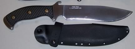

most (maybe all) of the kydex sheath makers I've seen use the method where there's an extra border (~3/8" or ~1/2") beyond the size (side view) of the blade width/shape where the fasteners are located (often around three sides of the perimeter) that sandwich the two pieces together...
while the whole kydex sheath is pretty flat using this method, it's particularly wide, especially on bigger blades (which I'm looking to avoid if I can). some of the leather makers, however, end up with a different profile - resulting in a thicker sheath with a narrower overall width that hugs and follows the blade contour more closely.
anyone make, or might be able to make, a narrower but thicker kydex sheath for a BWM like I'm describing? I basically want the size and shape of a slender leather sheath using the utilitarian durability of kydex instead. maybe by bending those flaps around to the back or something? will kydex bend like this and work? anyone even tried?

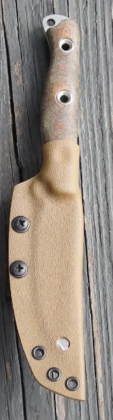

Dozier kydex is super narrow (and thin) and is the most compact kydex I own. Here's a pic of a custom filet I own:

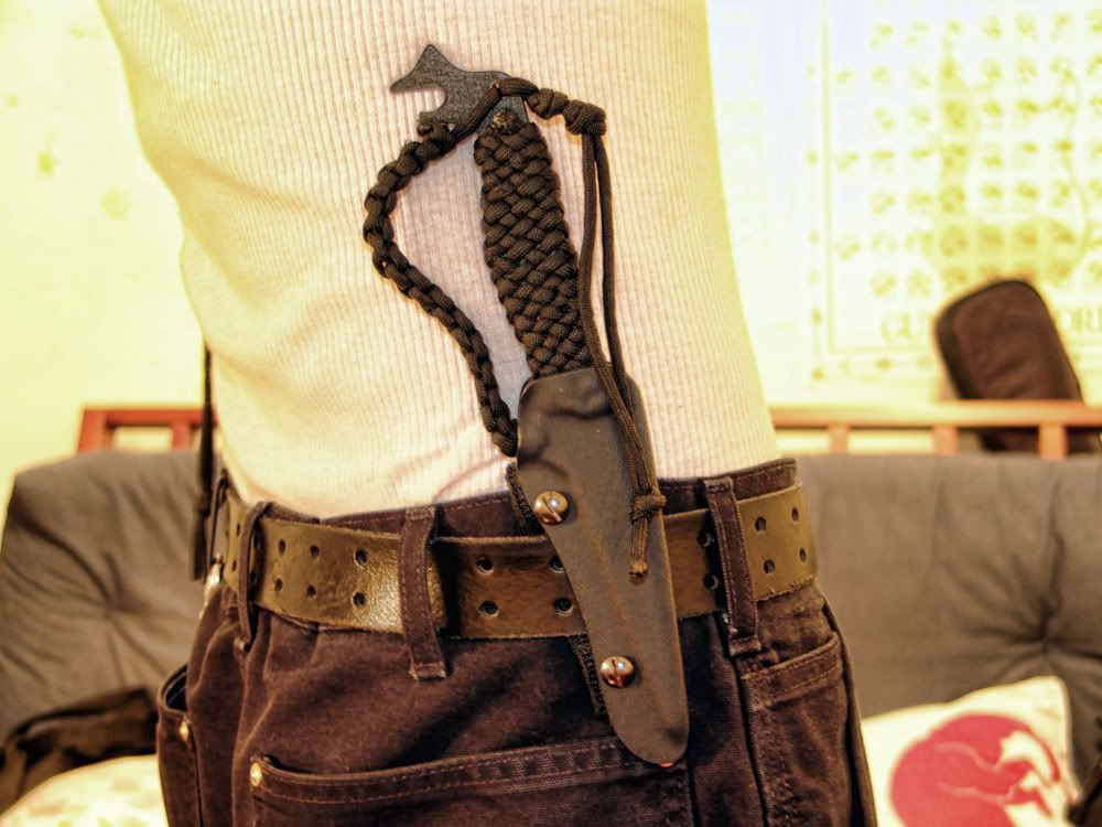

Dave Brown is the original king of "low profile" kydex, and he has some really nice patterns.

There ya go. Did I say Dave was the king of low profile or what? :D

what dave showed is as close to the profile of a leather sheath as your going to get, with only a small portion of kydex on each side of the sheath. If you inted on using a rivet style to so you can use a detachable belt loop like a tec-lock I'm sure there are several sheath makers who could do it for you, but they might make a scrap sheath or two in the process, depending on how many they've made in that method.

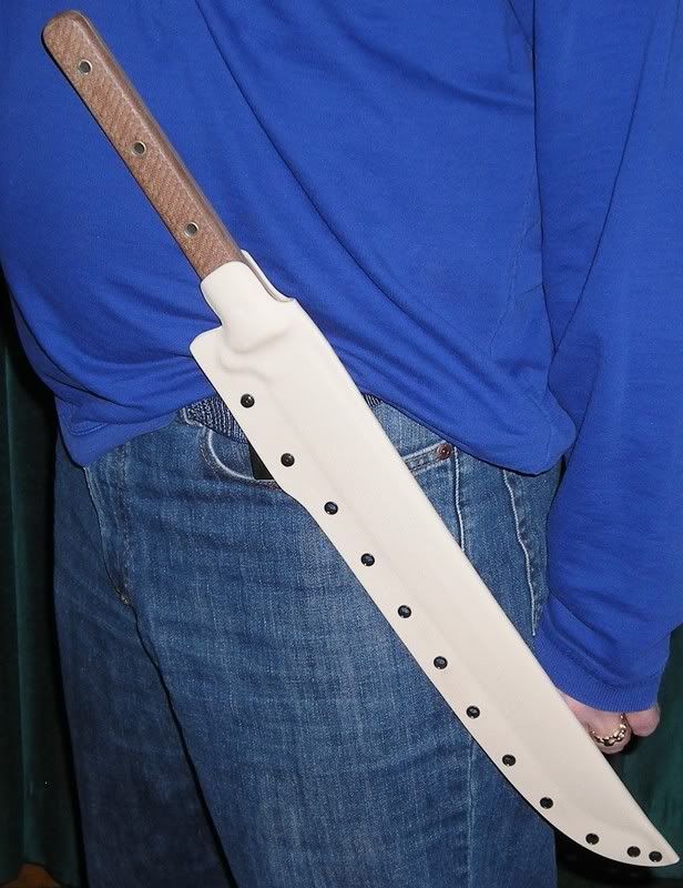

This is one of the lower profile sheaths I've done, and theres still extra kydex I could have removed:
