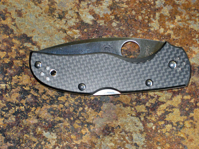

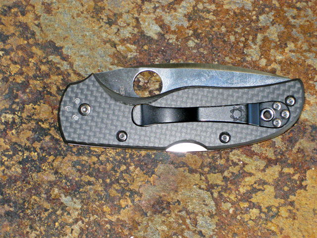

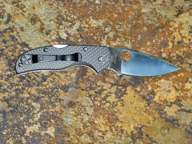

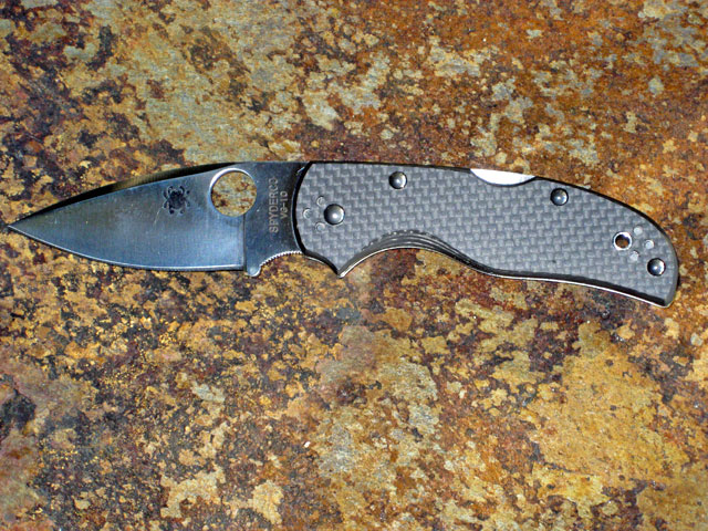

rmc85's pictures of his new Native4 showed what a pretty knife it was. The carbon fiber and FFG looked really good. After finding out that a couple online retailers had it available for less than $100 I had to get one for myself.
My first one arrived last week from Knifeworks. It was even nicer looking than the pictures. Opened it up and it felt kind of "gritty". Lubed it up around the pivot area and opened and closed it 20-30 times and the "gritiness" just didn't seem to go away. I noticed some arcuate scratches starting to form in the tang area over the "Seki City" stamp. Not good.
Contacted Knifeworks and they gave me an RMA to send it back. Talked to Kaylee after a couple days to make sure they got it and she said that she had it right there and that Roger would check the replacement to make sure it didn't have the same problem.
My replacement arrived today and Kaylee and Roger were true to their word. Seems to be better than the first one, smoother to open for sure. Here are a few pics:
This is a fantastic little knife, especially for under $100. :thumbup:
I guess my only question would be has any one else noticed a similar problem? My guess is that one of the lightening holes in the liner had some rough spots. Unfortunately I didn't take any pictures of the first knife.
