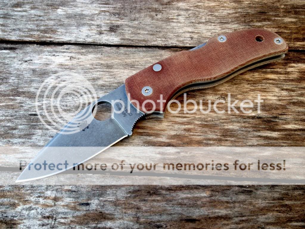

Wondering if the stock G10 scales are thick enough to get a texturing like this
I know it's not a Native.
I'd also love to stonewash the blade... looks pretty amazing. I saw some DIY threads about that as well. I have a Strider Buck Tarani I can practice some of this on before committing to a buy on the Native.
The stock native scales are fairly thin at about .94" so there isn't much room for texturing. Could be done but it will have to be shallow cuts.

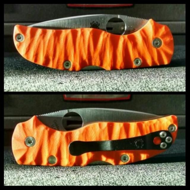

Here's the native I did for Radioactive a while back with ⅛" G10. Thanks for the mention bh49.

Hey, I recognize that sweet looking orange Native 5! I can't express in words how awesomely precise and beautiful Steve Ketchen's scales are, he continues to outdo himself with every project it seems! He made the orange Anso sculpted G10 scales above and fixed up my Cuscadi desert ironwood ones as well (sunk the screws better, gave it his high sanding/polish). Steve's also outfitted my Domino, Dice and Southard in desert ironwood, another Southard in Ctek, and several more scales are planned for this year! Definitely check out his BF thread (especially his most recent black and white Micarta Native with the red pinstripe, holy cow!!).
So, needless to say, the Spyderco Native 5 is definitely mod-worthy!! Thanks again to Steve and also Luke at Cuscadi, who's another great source of scales. Cheers, DI aka Radioactive :)
