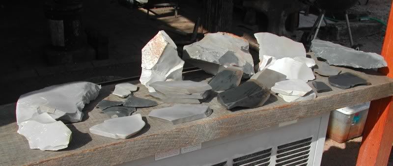

Also depending on where you live you may just have access to some really fantastic native whetstones! Arkansas is a good example because of the naturally occurring Noviculite that's more commonly known as Arkansas Whetstone's and it comes in several grits. I'm not sure if Noviculite is found in other areas or not but a suitable stone can be found most everywhere....
Here are some examples of natural Noviculite I found on another forum that belongs to a well known knife maker that is very generous in sharing information....:thumbup:
