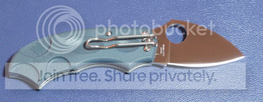

I just suggested this a week or two ago, but now that you bring it up, I can see an issue. When we screw in the clip screws, we want them to be as tight as possible to prevent any type of wiggling. If we use the pivot screw, then we would have to tighten that down all the way which would make the pivot too tight. The only way this would work is to have the Manix2-style pivot, which I believe is fitted exactly so that "all the way tight" is the perfect tightness.
An alternative would be something like the clip on the Meerkat:

The snugness issue is an excellent point. Like I said, I'm no engineer. :o Of the solutions you propose, the Manix 2 style pivot seems like the better one to me.

But then again, I do see another possible issue: what if one decides to NOT use a clip? Then the pivot will be too loose...

Then the screw would just screw further in until it tightened up on the handle scale? While it might be good in theory I don't think the tolerances are tight enough to ensure that every knife would have a smooth action. I can over tighten my Manix 2 fairly easy and make the blade hard to open.
