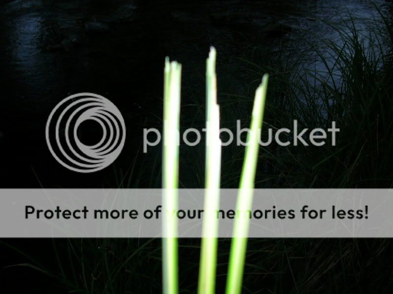

I guess I'm lucky having access to a particularily useful plant called the long leaf mat rush (Lomandra longifolia).
As well as having an edible growing end near the stem, the leaf itself makes a strong rope with little preprep required.
Depending on how thin you want your rope, the leaf can be slpit along its length, giving strong strips.

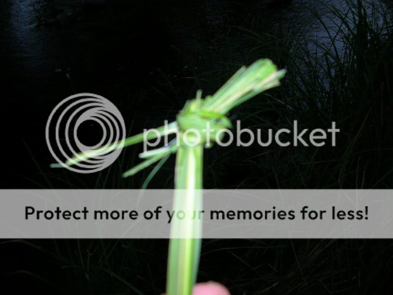

A simple knot to hold the three strands,

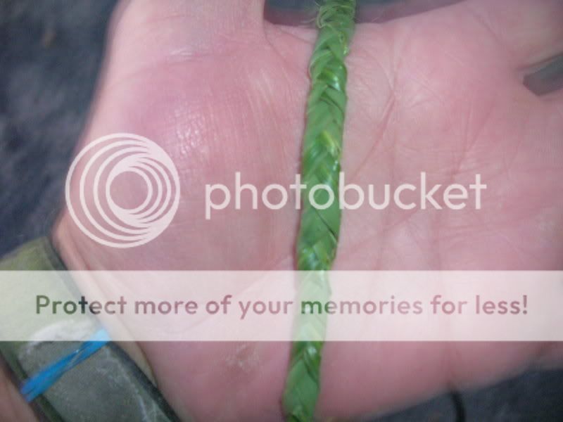

and then a simple three strand platt that produces a thin rope ...
...that's flexible enough to be tied in a knot...

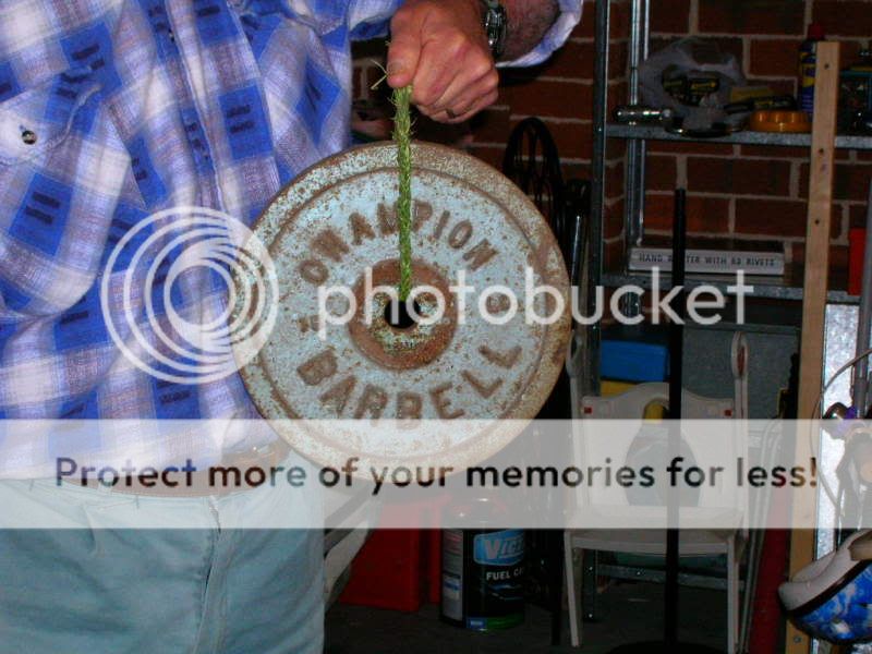

....and srong enough to support a 15 lb weight.
All up, it took less than 5 minutes to prepare :thumbup:.

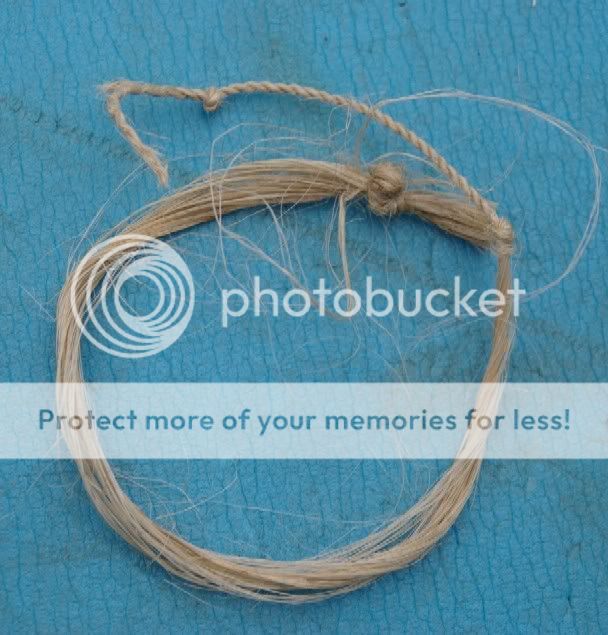

We have many natural fibre source plants around here (Southern Ontario, Canada). To name some of the more important ones - Stinging Nettle (Urtica dioica), Wood Nettle (Laportea canadensis) - my favourite, American Basswood (Tilia americana - inner bark), Common Milkweed (Asclepias syriaca), Swamp Milkweed (T. incarnata), Evening Primrose (Oenothera biennis - not as strong as some of the others), Indian Hemp (Apocynum cannibinum) - very strong, although a PITA to process, Spreading Dogbane (A. androsaemifolium), Velvet Leaf (Abutilon theophrasti) - (a very good cordage fibre and seemingly, a favourite of John McPherson), and some others.
Here is a picture of an old cordage display board, I used to use. The printing was done by somebody else and it obviously wasn't waterproof :rolleyes:. BTW, the long, dark red stalks on the left hand side are Indian Hemp.
This is a picture of some Wood Nettle cordage - still has to have the little hairs clipped/burned off.
This is a picture of Velvet Leaf fibres and cordage.
