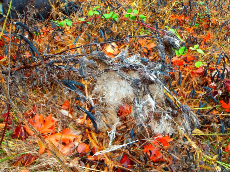

I started off with some fluffy seed pod type tinder, this could just have easily been old mans beard, Cat tail seeds or even Cedar bark shavings.....think of this as the wick.

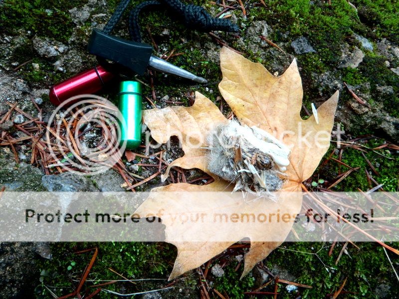

All ready to go !
This took 5 strikes of my well worn cheap generic ferro-rod to ignite.

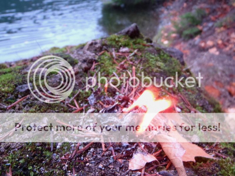

This was how it looked after the 5 mins just before I put it out.
