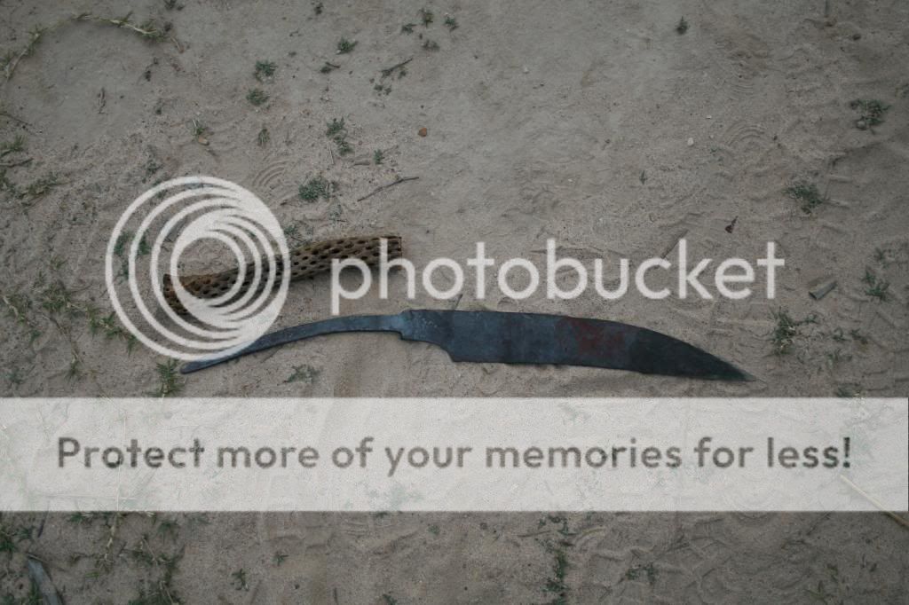

While i'm not a fan fan of avatar the story, i am a sucker for good production design. If anything it has helped me to move out of the bowie/trade knife rut i'd been in for awhile.
steel :1084
Edge quenched in canola and triple tempered 400
OAL - 24 3/4"
Blade - 14 Cutting edge 12.5"
Handle - Cholla cactus with an inner coat of epoxy. The tang is forged to fit the length of the handle. The tang is epoxied and pinned. The bolster is hemp and a macrame turks head knot sealed with shellac.
Nasty, horrible lookin thing. I like that a lot! Chop, chop, chop, slice em an dice em.
Cheers Keith
I'm interested as well. visitor message sent. PM not available.
That came out good! And it's proportional for a 9 foot tall blue cat person. :)
Now you need to do one of the AMP suit knives. :D
