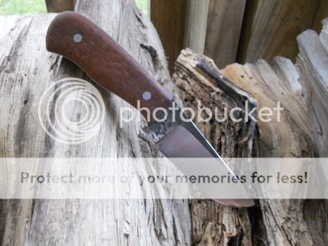

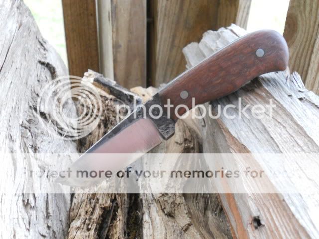

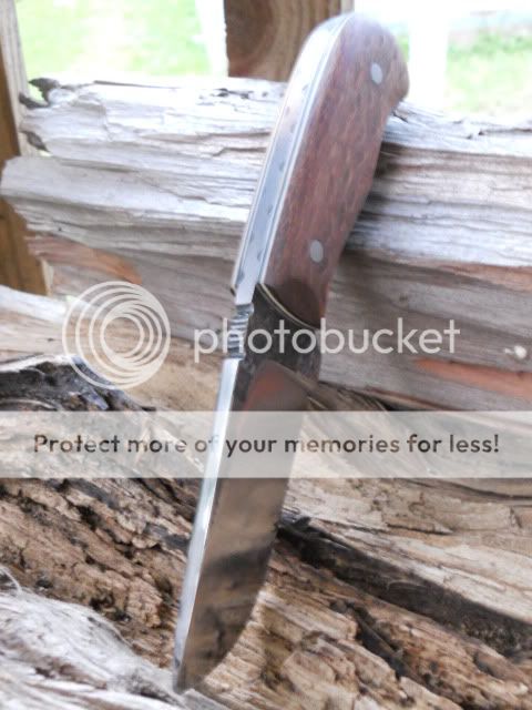

Here's a commission I just finished up.
The knife is composed of 3/16" L6 tool steel. It is 6 3/4" OAL with a flat ground 3" cutting edge. The scales are lacewood with alternating black and white vulcanized liners. There are 2 3/16" steel pins holding it together. It has some simple filework along the spine and a filed in thumbrest. It has a rounded and mirror polished choil, as well as the blade's spine and ricasso also being polished.
This one was fun.
Brandon
Nice little knife! Personally, its too big and thick for me to consider it a neck knife, but that's just me. I wear a neck knife all day every day, it needs to be light.
Nice work.
-Xander
I'm a sucker for Brute de Forge....
That is a very nice li'l fellar!
