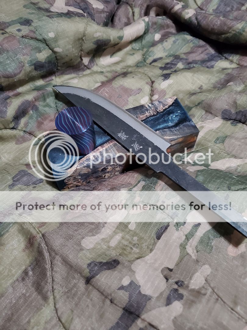

I was hoping to get a little help of info on how to find someone to make a handle for my blade. I have some stuff already. I was going to try myself, I still might give it a go, however, it would be the first time and would prob look like caca. Any help or advice would be appreciated.
