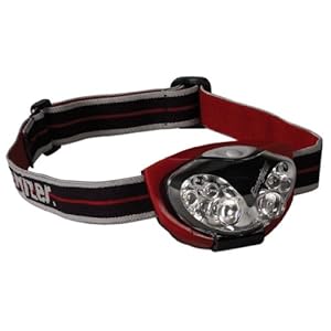

I'm in the market for a new headlamp. The only one I have right now is an Energizer 6 LED as shown here...
It's a pretty good light for the money, but I'm looking for something a bit brighter and hopefully with a longer run time. It will be my primary hands-free light for the outdoors at night, and thus needs to have a good throw. General-use, perhaps a just-in-case-the-zombies-come light, perhaps a bicycle light for night use. I'm not too concerned about super brightness, but throw is a must.
My budget isn't high at all - around $30 plus shipping - but I'm hoping I can get something good in this price range.
Any recommendations?
