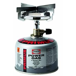

I have that Primus Classic Trail, a Snow Peak Giga, and an MSR Windpro.
Classic Trail - very wide burner, with pretty good flame control. The best choice of the three for really big skillets. I have cooked rice with it, too, and it does fairly well at low levels. However, with the huge burner head, you have to have a minimum flame level to keep it going and it won't turn down quite as far as the other two.
