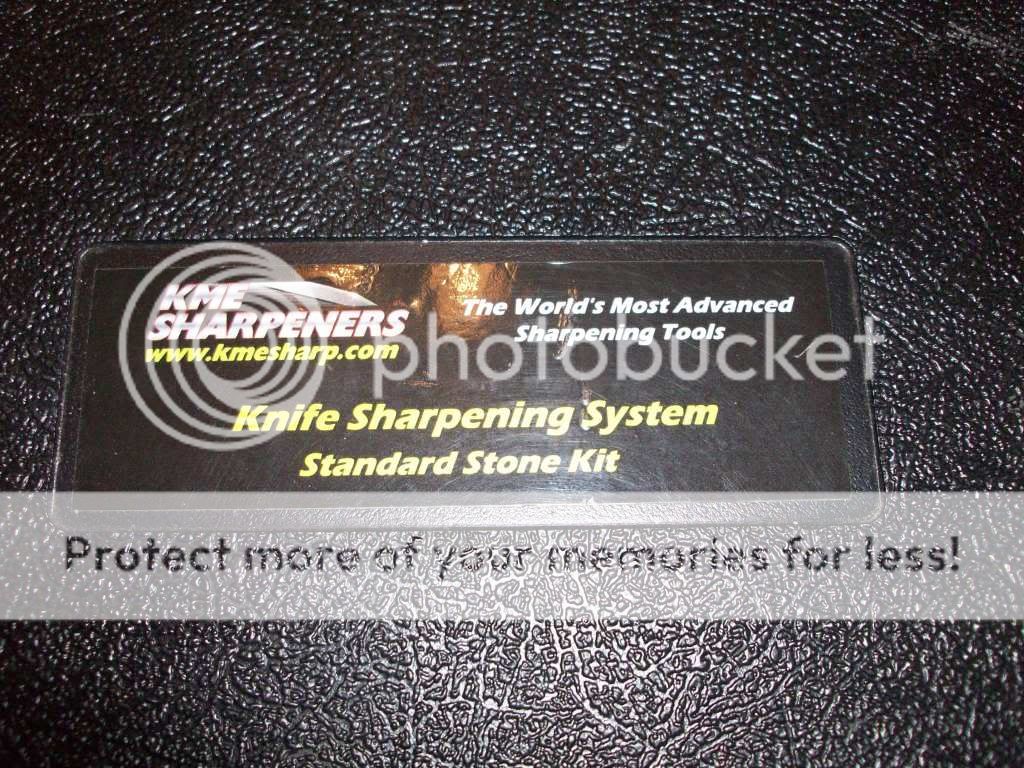

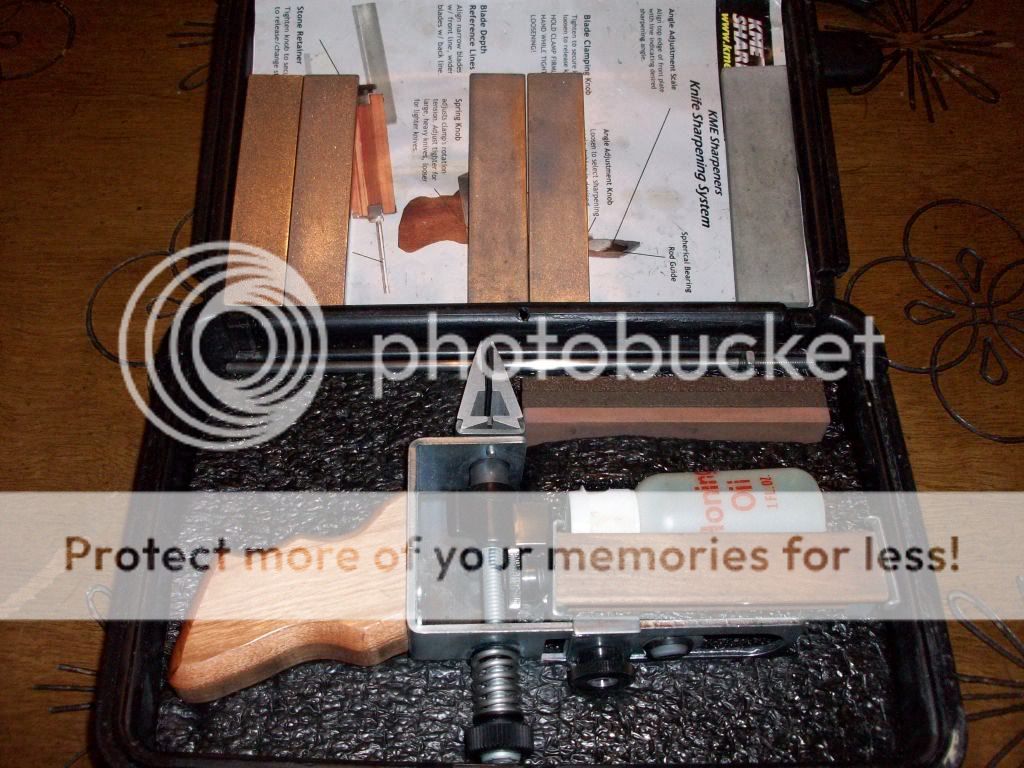

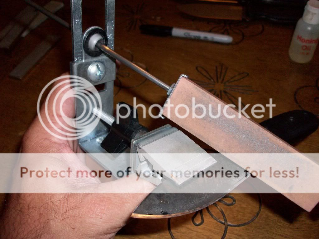

KME Systems.
About twice as much as you are interested in paying, but made in USA, and worth every penny.

Moose is right about KME - fantastic system. Easy clamping and the clamp does a great job holding many different knife types and sizes. About twice what you are looking at in price but it has the least angle play of any of the systems on the table, and the most angle choices. Also more stones are being cut for it, if you are thinking you will want to try other specialty stones at some point.
