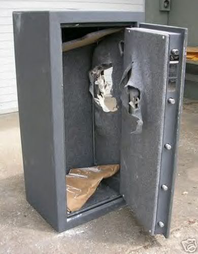

The picture below is of a Liberty Safe (10-12 gauge ?). It was entered with a common axe, within 5 minutes. Liberty, Champion, etc.. make Residential Security Containers, not safes. Get a minimum 3/16 inch outer body for RSC's. Generally, fire ratings can be compared with the thickness of gypsum board. Get a larger capacity safe than you think you need. You will fill it up. Educate yourself and ask a thousand questions, call the manufacturers themselves. I would recommend a high end Ft. Knox for RSC's. Dig deep in your pocket and make it hurt a little (alot), or save your $1400 and hide everything. IMHO.
I have a Champion. It seems good to me. The body is a double wall of 3/16" steel. I have no misconceptions that it's impenetrable. As was recently demonstrated in Brazil, no safe or vault is impenetrable.
