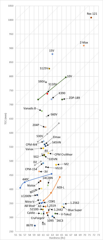

Sorry Hugo but I'm afraid you've never skinned an animal.
Dalibor is my neighbor and friend, thank you for your kind words but it seems to me that you have miss the topic ... the hunting knife that is supposed to do the job needs to retain its sharpness and the 52100 cannot achieve even 10% of what modern steels offer.
And you ma'am, the shoes you can't walk in are also Gorgeous ...
given how you described your esteemed husband I think he would appreciate the tool he uses more than it just looks nice ... and a compromise is possible to make it look nice and purposeful.
All the best for the wedding anniversary
https://www.bladeforums.com/threads/4-fixeds.1774807/
Hello! Never skinned an animal, but I’ve allways regarded 52100 as a steel that retains it’s sharpness for a good time. And I recall reading that at least one of the makers suggested above used 80crv2 on his hunters, so 52100 seems more than capable! Even not being a hunter, animals are dirt and those dirt may cause microchipping in those “super” steels. Of course, the OP can give Fredrik Haakonsen a call (another great guy to deal with) and he will make her husband a hunter in Vanadis 4 extra, hardened to 66hrc and it will keep its sharpness forever (cutting soft materials)! But wasn’t the knife forged? Good luck forging “super” steels!:D
