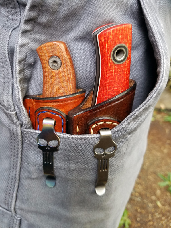

I have 3 ISP sheaths. The first one stays in the pocket well but the other two come out easily when I try to draw the knife. Any suggestions? Im not married to the inside the pocket method but I need something secure. Tried other ways as well like inside the pants, between belt, etc. and no luck. Love the quality and want to make it work.
shane
Your knife is fitting too tight inside the sheath. If it's one of the bigger 4" recluse sized sheaths .. I recommended against carrying one of those ISP style, but demand prompted me building them and I'm using my heaviest clips on them. You will still need to fit the knife to the sheath properly. I build my sheaths on the smaller end as to fit tight to the majority of Fiddlebacks .. this is done because Andy 'hand shapes' his handles. One month he's making fat handles, the next month knives are coming out with thinner handles.
It's easy to stretch leather .. such as a breaking in a new pair of boots to your feet. It does not work that well vice-versa. Search for wet forming. Its not my favorite thing to do .. but it will 'fit' that particular knife to that particular sheath.
This is what I cam up with for a solution. I noticed that there is more space on these clips than on my first one so it is not clamping down on the pocket.
shane

Is it an issue with the knife being to snug or the clip? If it's the knife just give it time. I have found that it can take a week or two of constant use to get the leather stretched enough to allow the knife to be removed without the sheath also leaving the pocket. Which is much better than the sheath being too loose. If it's the clip I have noticed that the Punisher clips that I have do not have enough room above the nose to accommodate the material of my pants. However, I normally do not re-sheath my knife while the sheath is still clipped to my pocket so it does not bother me. It would be nice if it sit flush with my pocket, but it's not a deal breaker for me.
It should seat all the way to the bend of the clip unless you're wearing some serious thick material for pants. I bend them so they'll pinch the material with some grip. I believe the clip he's having issues with is my thicker/plain clips .. and they have much more retention than the thinner/themed ones.
BTW, do not push the butt of the knife while it's sheathed in an effort to push the sheath/clip further into the pocket <-- that can cause the knife to push through the sheath's welt and into the stitching, thus cutting the stitching.
I use a small needle nose vice grip to clamp down on the clip to tighten it and give it better retention. I also put an old t-shirt over the clip so it doesn't get scratched up.
The clip on this sheath fits perfectly. Slides over the pants pocket and the last quarter inch is tight and really clamps down on the pocket.

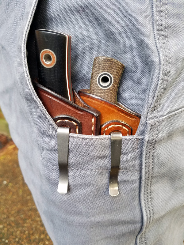

My Runt would also pull the entire sheath out of my pocket at first . But after a few hours of watching tv and sitting on the couch fiddling with it "no punt intended " sliding it in and out breaking it in it now performs flawlessly . I also gave mine a few coats of Obenauf's heady duty LP leather treatment when I was breaking it in .
Also with mine that has the mandorlin ti clip I find with some jeans it bites in better and seats deeper if I gently pull on the clip when sliding it into and on to my pocket .

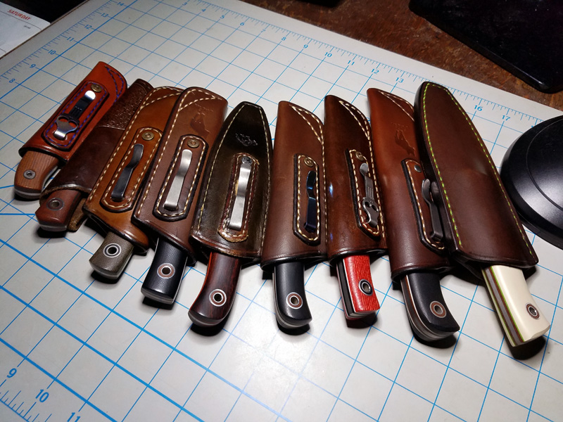

To the point about the clip slipping, I only had this happen to one of my ISPs from Bud ( I own six). It was a knife that the sheath wasn't built for, but the dimensions worked and I love his sheaths so I went for it. I solved the clip slipping off my pocket by wrapping a thick plastic bag (ziplock freezer bag thickness) around the end of the handle a couple of times, sticking the plastic wrapped handle in the sheath and leaving it for a couple of days. I don't like wet forming and have found this to be a good alternative generally for new sheaths and holsters that have a firm grip and need a little stretching.
