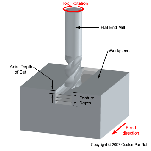

Here's an article
http://www.mmsonline.com/articles/hard-milling-by-the-numbers
to muddy the waters further. They recommend much higher F&S (but are likely using carbide, and larger tooling) but they do bear out the tiny DOC.
Axial cuts are full width and they recommend 5%-7% of the cutter. That would be .004"-.006".
