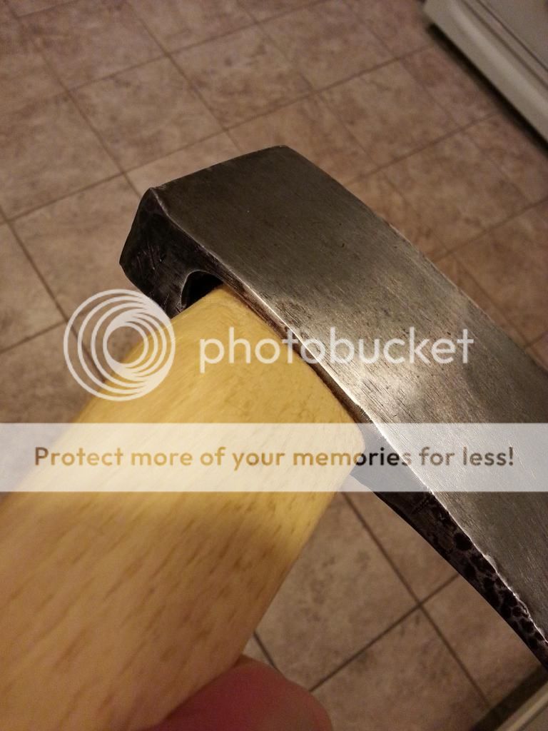

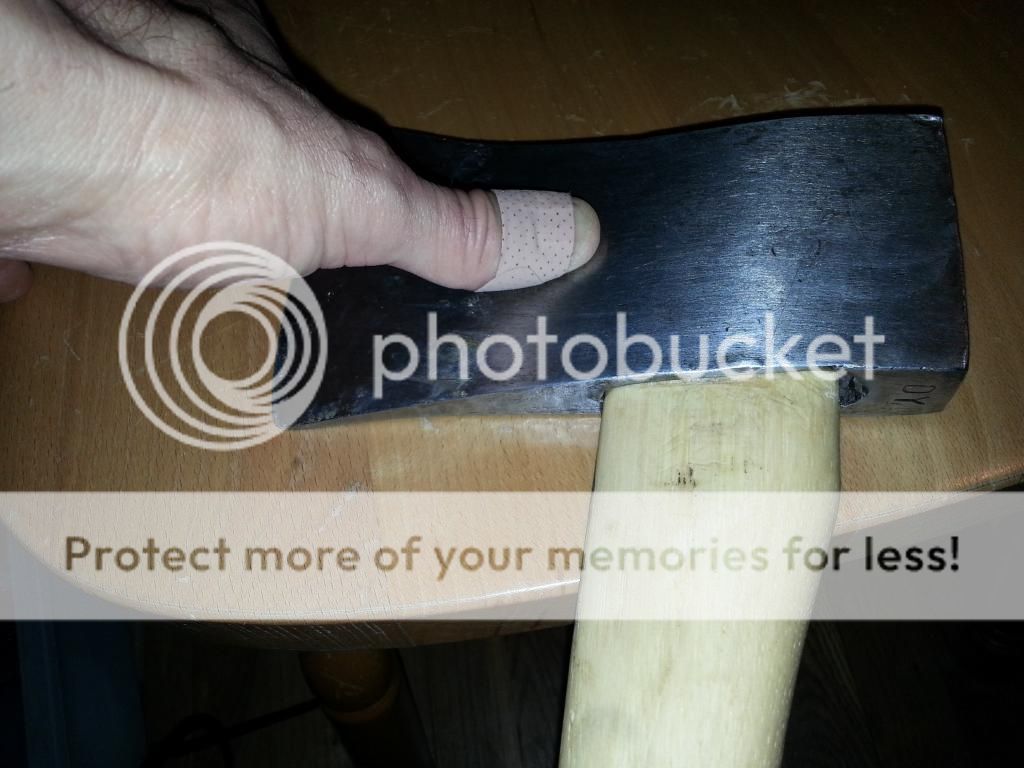

So I hung a boy's axe head that I have been playing with for a few days on a Link 28" boy's axe handle. Looked like a good fit. I spent a ton of time getting it correct, and only when I wad well into it did I realize that the handle was not actually the ideal fit for this head. It is a 2.5lb head and the eye is definitely too small for a regular handle, so I just assumed... anyway I'm too stubborn and was not going to quit at that point. I figured that the handle would need to re-purposed into a hatchet handle anyway so why not see if I could make it work. Whether I failed or I quit, same difference. BTW, no material was remove from the front or the back, that is how it came. I only removed wood from the sides.

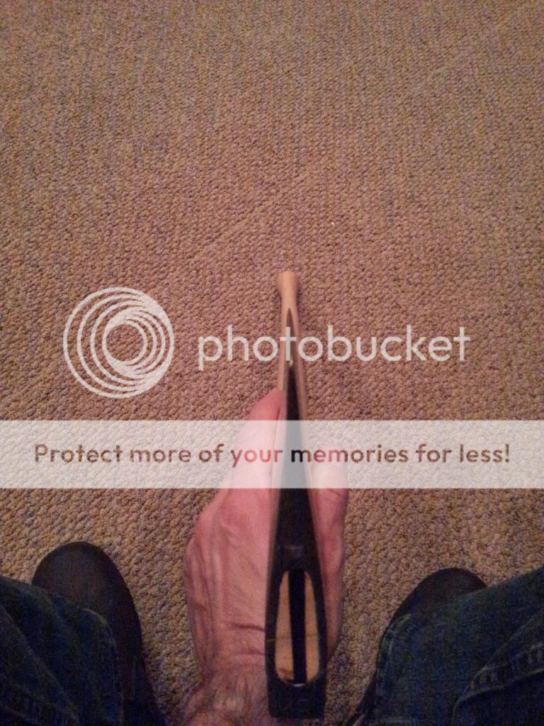

The problem is that there is not as much shoulder as would be preferable, and front to back the handle does not quite fill the eye. Up top is OK, and I made sure to make a wedge that was as tight as possible. Down below, if it would not fill the gap I made sure to have it at least tight up front. There is a gap that you can see. Not good but in the least bad spot as far as I can tell. My question is this: is there a recommended way to fix this? Should I fill it by driving a wooden shim in there or filling it in some other way? I would like this to work if at all possible. Worst case is I test cut and it comes loose, I take it off and re-purpose the handle. Best case I can make this workable as it is.
I'm guessing that you hung your head upside down. The bigger side or opening of the eye should be at the top of the axe. This allows the wedge to spread the helve in the eye for a firm fit.
Measure your eye...Do you have it upside down?

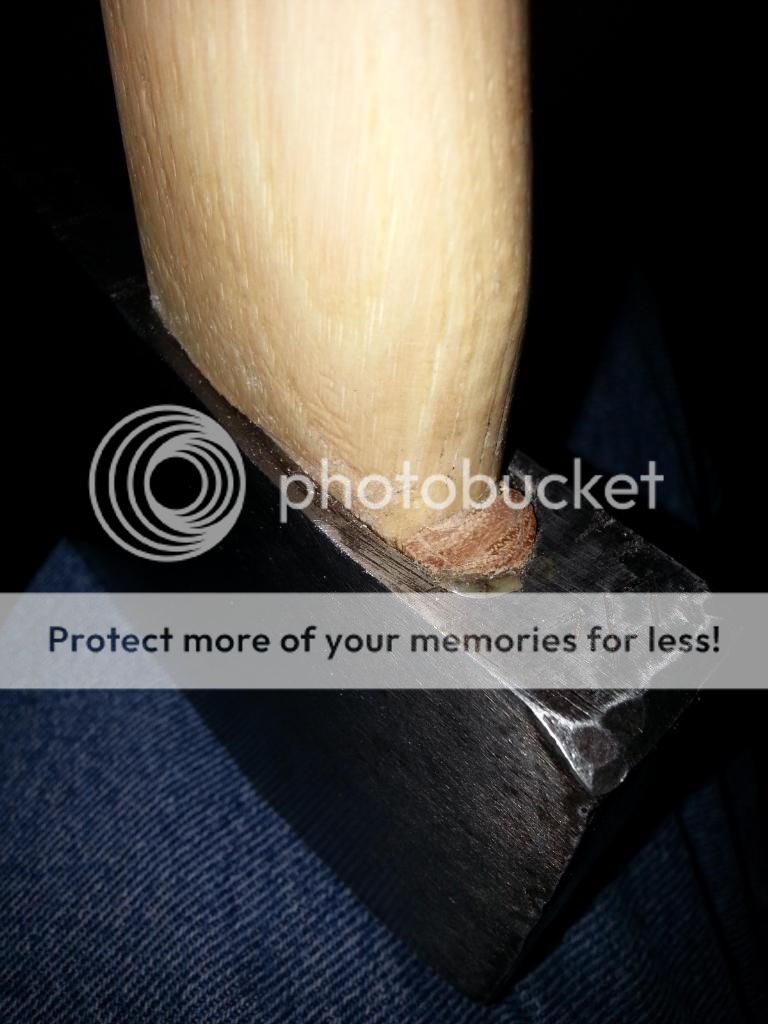

Already done LOL. I have a pile of cut off handles, I sliced a small piece off of a good section, then hand filed it as best I could into a thin wedge but maintaining the round back to make good contact with the eye. I put some wood glue on it and drove it in. I'm not cutting the excess yet, I'll let it dry first. I will tell you, it feels rock solid, I cannot budge the head with my hands. The real test will be a few swings into wood. There are a few gaps that I will fill in somehow for aesthetics. This has been a good learning process if nothing else, and if a working axe come out of it, bonus.

Looks like maybe a full size eye. Its not going to work for long. House handle has what you need. Full size eye, short handle.
Most boys axes are 2 1/4. Eye sizes are not as standard as you would believe either, they are pretty varied. Smaller eyed boys axes will fit nice on some hatchet handles for instance.

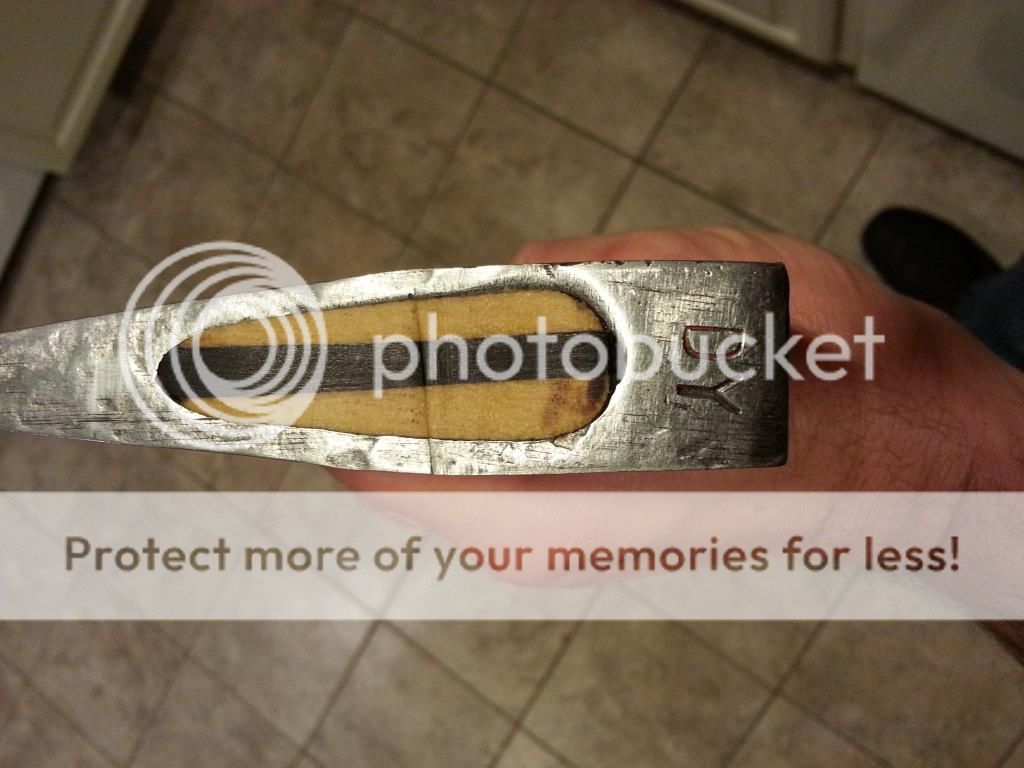

I thought of that, but looking at the pattern, it would look so wrong if flipped over. I guess that could still be the answer, but that would be really weird.

I have a couple of options. The shim is in and it looks and feels super solid, just won't win any beauty awards. I could leave it and see how it goes. I can take it off and try to save the handle. If I wreck it, it will become a hatchet handle some day. I can wait for the new House Handle, but I want to finish this and move to other projects. I have house axe handle that would be a great candidate, but that is being replaced as well, same wait.

Could you potentially pull the wedge and seat it lower to the shoulder?
Not really, if you look at the first pic in the thread you can see that it never gets any wider front to back. Honestly, its all wedged in and the bottom wedge is glued. Its done. The only thing to do is try it and go from there. I'll try today, I'll chop through a 4-5 in maple branch that's in my yard and split a few pine rounds. After that I'll evaluate it.

hello, it is weird because pattern says you hung it the right way,but letters d y say no, they usually are at the bottom facing the haft, not the top...

So I don't know if splitting frozen pine and only one knot for a campfire counts as a true test, but this axe was used tonight and it is a solid as before. Passed it's first test anyway.

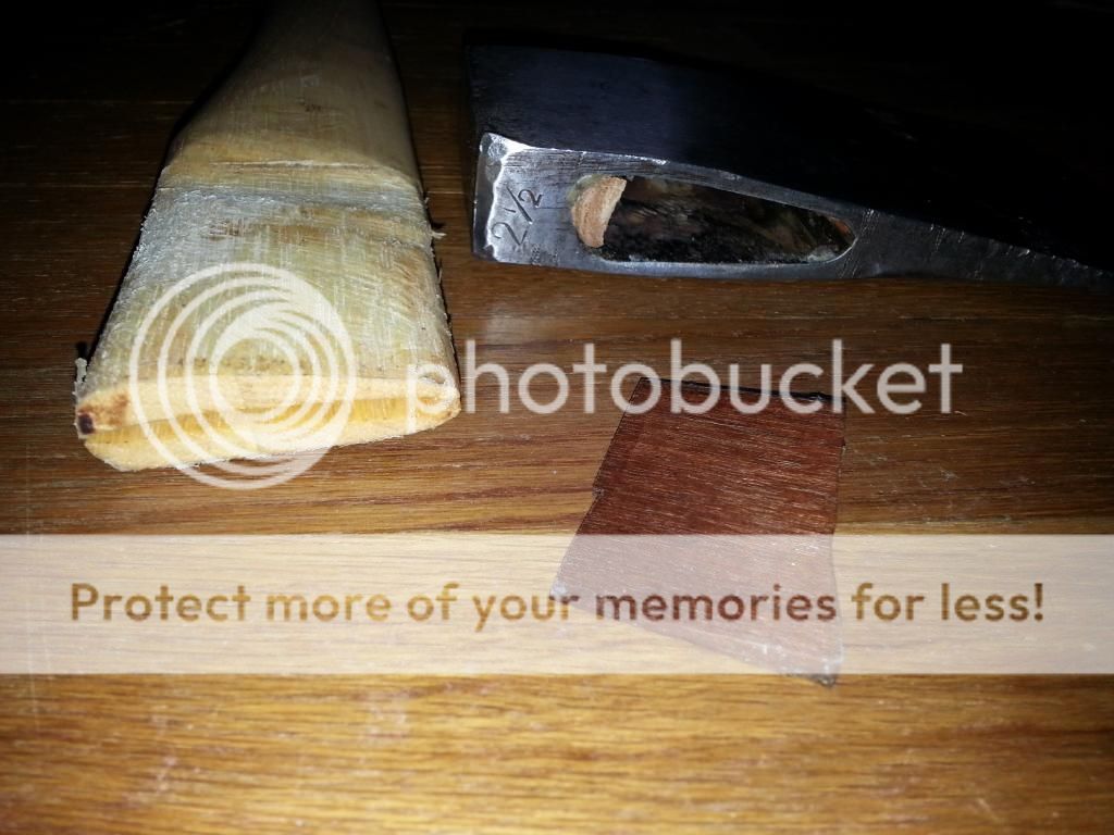

I chainsawed a roughly 7 inch hardwood of some sort leaning on my fence earlier this year and left maybe 5 feet of it. I took this axe to remove 4 more feet and the head was half an inch loose after about 10 swings. I stopped and took it the rest of the way apart. But hey, my shim held LOL. Enough, this handle will be saved for a future hatchet head.
Incidentally, it was wrong mounted the other way too.
Kids, what did we learn? Use the right handle, and check it ahead of time. Case closed.
