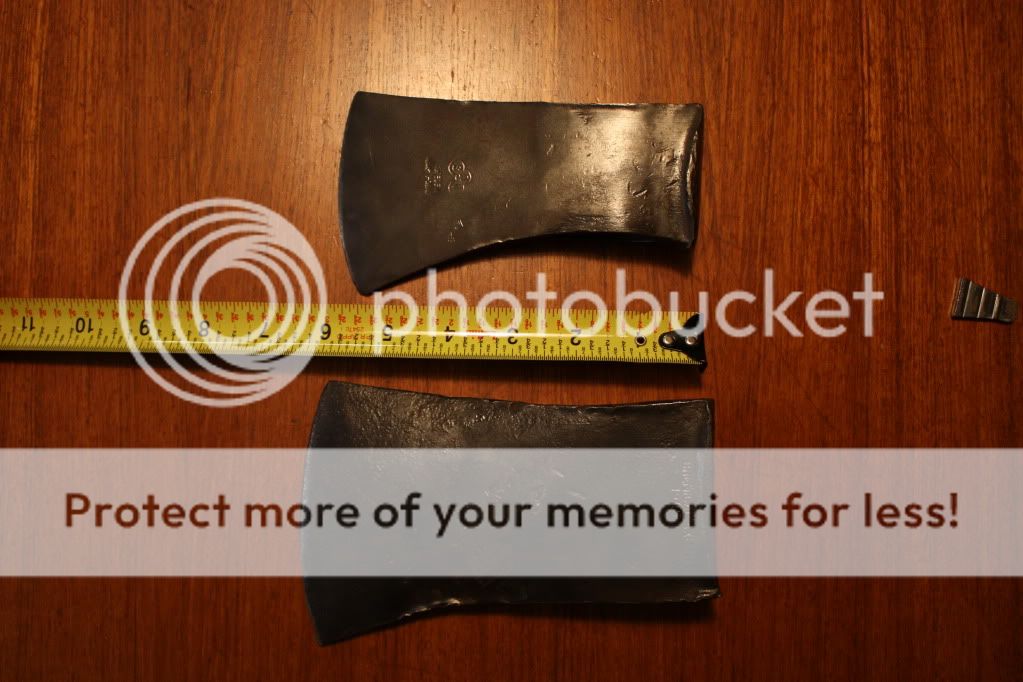

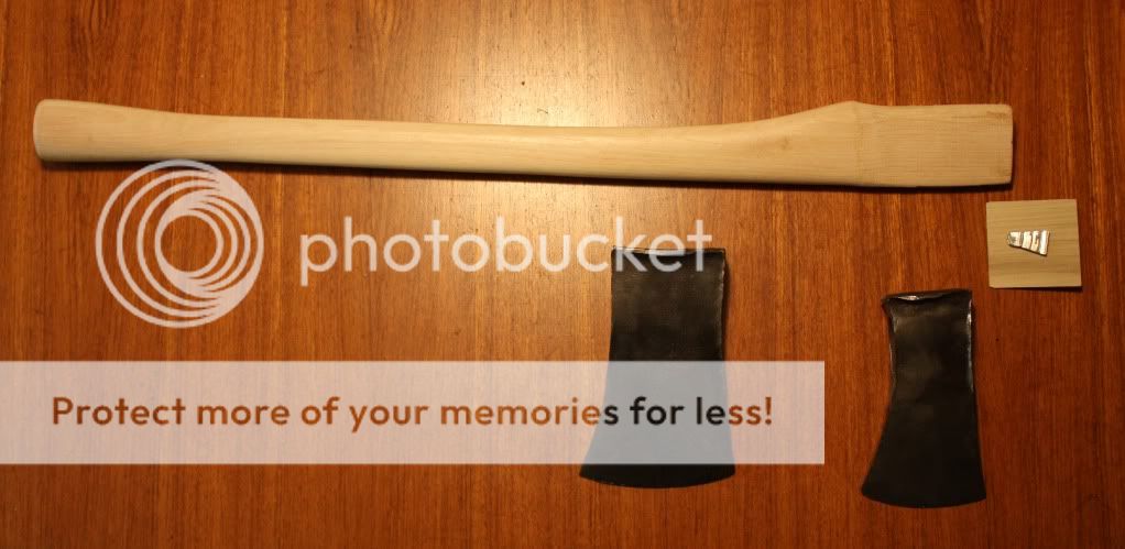

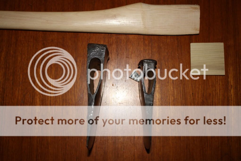

After reading "The Ax Book" by Cook, on the recommendation of someone here, I decided not to buy a regular store-bought ax, and go a different route. I got a straight 28" handle of hickory from the Hickory Handle Store on eBay. I bought an ax head before I got the book, and the seller gave me another. I'm not even sure they are what I want or need. I'm thinking, since I'm a beginner, and starting late at age 50+, I need something around 2 1/4 to 2 1/2 lb.
One head I have is marked Sager Chemical Axe 1945. It's 3 1/4 lb. It's 6 1/2 by 3" at the poll. The bit is 4 1/4" The eye is 2 3/8 x 3/8".
The other is a Weeterlings, only 1 3/4 lb. It's 6 by 1 7/8". The bit is 3 1/2". The eye is small, only 1 3/4 x 3/8"
Here are some pics.
The handle fits the Sager, but would need considerable trimming to work with the Wetterlings.
The Wetterlings is in tough shape. The poll is severely peened over, from use as a hammer, I suspect. The top opening of the eye is also peened such that it is smaller, with a substantial internal ridge, so it would have to be filed to open it.
I like the Sager, but feel it might be too heavy for me; and, I'd like to straighten out the bit, a bit.
So, please, any and all advice and information is sincerely appreciated. As it stands now, I think I'll hang the Sager, sharpen it up, and see how it goes.
