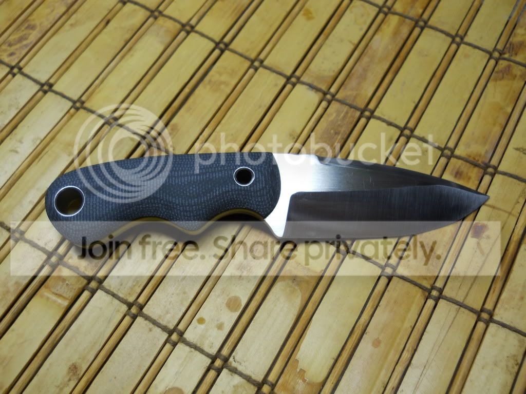

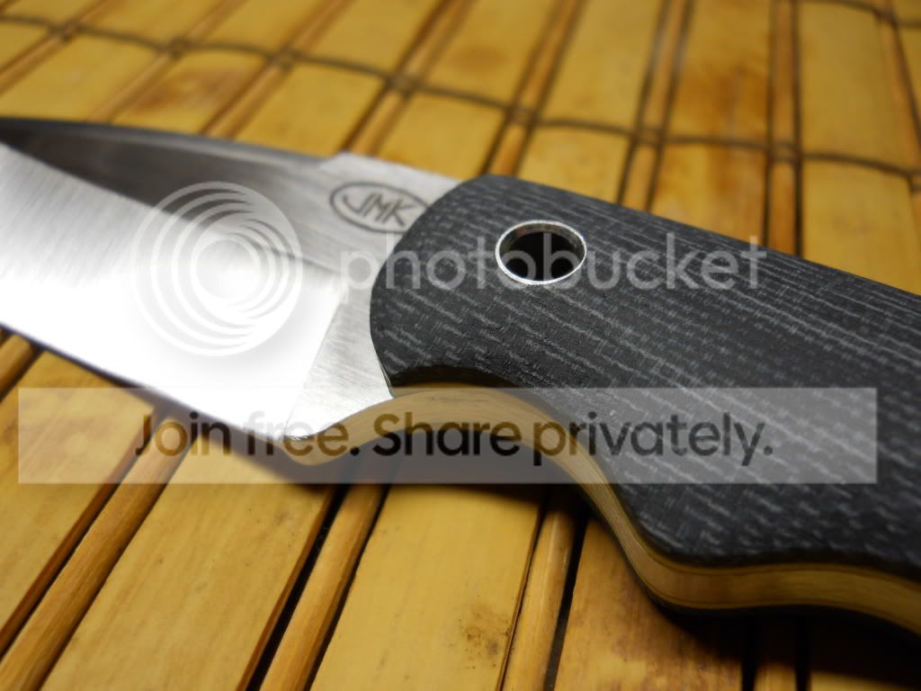

I love working with micarta. Like the other guys said, micarta is tough, consistent, easy to work, and looks great. I use a mix of the methods mentioned above. I usually do rough shaping with a semi worn 60 grit zirc belt, but like Salem said, I would only do that with handles your familiar with because it can cut quick! Personally I like to use my small wheel attachment with a 3/4 inch wheel for most of my handle shaping. I hold the knife vertical and at an angle to the wheel and run it up and down until I have the nice rounded shape I'm looking for. Then I blend in the shape with 100 grit wet/dry paper, then 150, 280, 400, 600, and 800. Sometimes I stop at 400 depending on what type of look I'm going for and sometimes I'll buff with green compound after 800 if a customer wants some shine.
Here is one I worked on tonight that's only been taken to 150 so far. Sometimes even this finish can be really attractive. It all depends on my mood I guess. Have fun with it!
