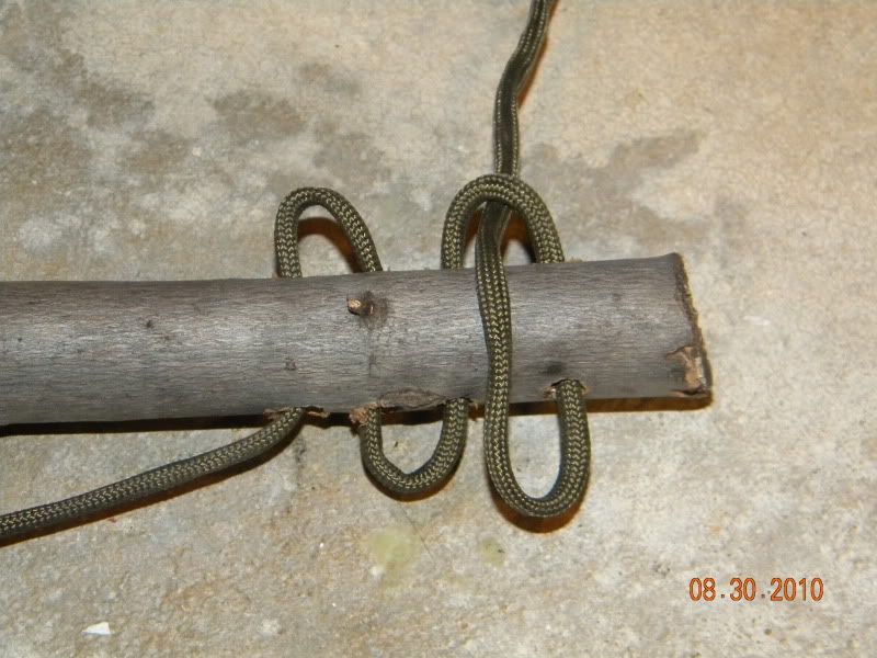

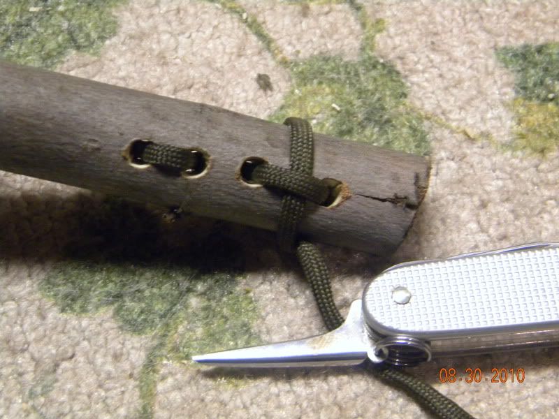

You have some string slip going on as well, try playing with the tension of the string. Seems to help me. I use a 4 hole method that works pretty slick and is worth the effort.
Like this:
and the other end, just an overhand knot:
By the way, not my idea.
