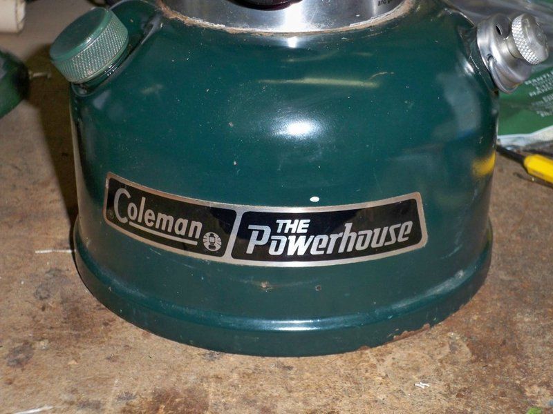

The lantern

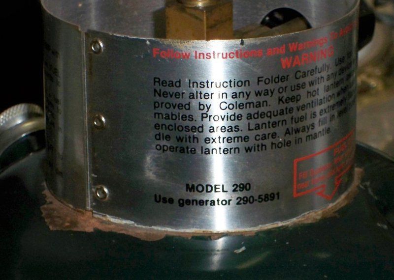

The collar

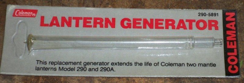

Generator packaging

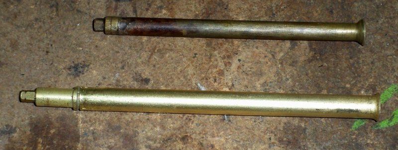

And the original and replacement generator demonstrating the size difference
Contact the company directly with photos and dimensions of the generator you want to replace. I suggest you don't modify the lantern. Molitov lanterns are no fun.
I would also call them. Moding a pressurized gas lantern is probably not a good idea.
