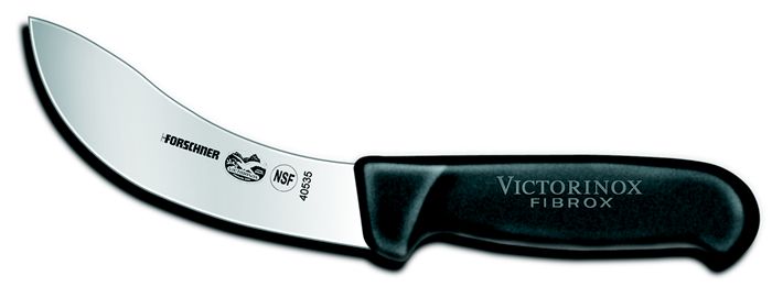

However there are a few long skinners around. My opinion is a knife like that is for pulling double duty, a butchering knife you can use for dressing game. Here's a 6" from Forschner, designed for hogs and cattle:
