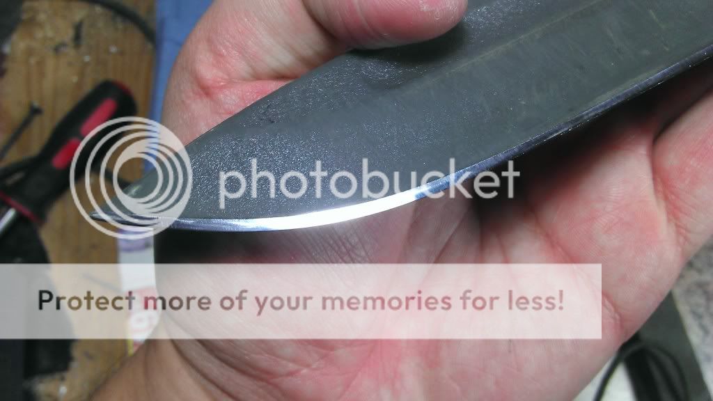

Results:
The best one, oddly enough, the first knife I did on the EP system:

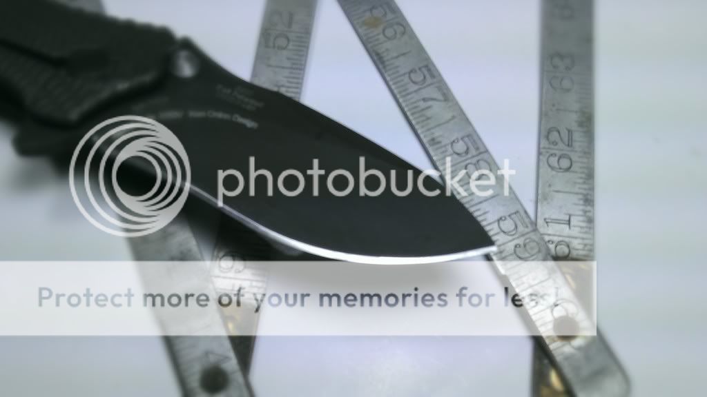

Rushed this one a bit so it's not as consistent:
Same here. :foot: Still an even bevel, but I should've cleaned up some of the scratches before polishing the edge.
If you're patient the EP can yield fantastic results. I'm working on a full reprofile of a Strider SNG in S30V and it's taking a LONG time. I started with the 320 grit and am going really slowly to ensure I get great results and a really consistent edge profile. So far it is going really well and the edge looks :thumbup::thumbup::thumbup::D
IT's amazing how even it makes the bevel... I find that it starts shaving once your done with the 220 stone, 400 stone for a good slicing edge and 600 just to smooth it out, these 3 stones make the biggest difference. If I could do it again I would have got the 1 kit and 3 after-market stones 1 rougher stone, and 2 finer.. I just got the apex 4 kit, here are the first 2 I got done with 120-6000.
