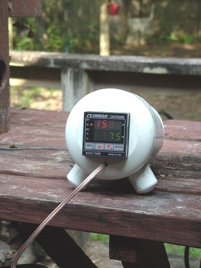

Here's what I came up with. It's a controller that I bought on eBay. It's being sadly underutilized as just a pyrometer but I may have a salt pot set up one of these days. It's connected to a type K thermocouple from Omega with all copper speaker wire:

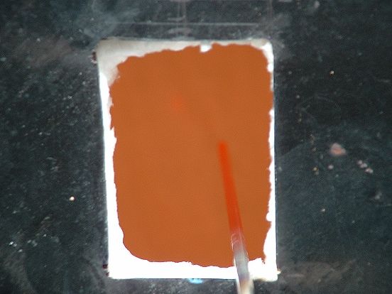

Here is a picture of the probe in my heat treating forge, the controller was reading right at 1500 degrees (and yes the isuwool is uncoated but the forge is outside and the insulation is not subject to mechanical damage, I do however intend to coat it to see if it makes the forge a tad better insulated):
This probe is inconel sheathed but will eventually burn up like probes of any kind will especially if you use it at welding temps. This unit seems to top out at 2500 degrees fahrenheit when we used it to monitor a smelter a friend of mine and I were running in an attempt to make steel from local bog iron. I believe that is a function of the upper limits of a type K probe. There really is no need to monitor welding temperatures, however in conjunction with a trained eye, a pyrometer is worh it's weight in gold for heat treating operations.
