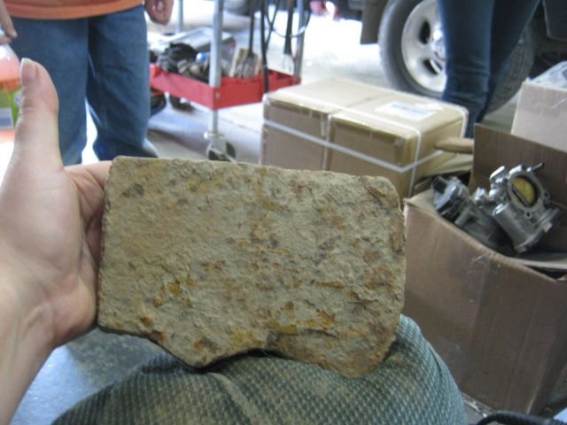

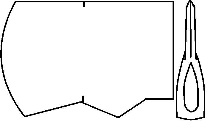

During an exploratory dig of an old burnt down overseer's house (burnt 1942) as part of the historic poor farm, we discovered an axe head. It could be newer than what we're looking for, but it might be right where we want it to be, as well. The poor farm operated from the 18teens to 1950 (give or take a year or two). It'd be really great if this axe head fell in those years. We found a few other things on our dig, but this particular item is too rusted to see any identifying markers. Here's a basic drawing of what the axe head looks like. What we'd like to know is make, model, approximate years of manufacture and a cost at the time. :)
A picture might help to date it. Earlier axes may show a bit more evidence of hammering. After 1890 or so axes were more finely finished with grinding and polishing to eliminate the remaining hammer marks. Those lugs are characteristic of various patterns, most commonly the Jersey pattern, but earlier Pennsylvania smiths used them too. It may be impossible to determine the maker since different companies made similar patterns. Still, pre-1950 most likely.
It's a Jersey pattern. Virtually every major axe maker used that pattern. No way to ID it unless you find some markings when you clean it up (if you clean it up). From the very square shape I would guess that to be an older model - it just doesn't quite look right for a late Jersey. Take this all with a grain of salt. Two years buried in cow shit will make a brand new axe look like that.

PS Looks like a Kentucky pattern, (in the Jersey family as stated above). Where is the farm?
Also, if it is from pre 1850, it is more than likely a local product, especially if on a farm, as most product on a farm during the 1800s where never more than 20 miles away....not always but usually. So the location could have a lot to say about who made it. If it is post 1850, it also grows in chance to come from one of the major axe manufacturers, Kelly, Mann, Collins, Plumb, Warren.
Of course it could be from a local yocal blacksmith down the road in 1880 and you can take everything I said and throw it out the window - hence why I love axes.
