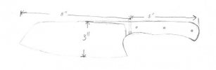

Here's a couple rough sketches of what I've got in mind. The dimension are not set, but it'll give him some idea of what I've got in mind and where to go from there. I like the first one with about a 6" blade, by about 2 1/2" wide.

Almost forgot, if I make it from carbon steel, I'll probably forge it from 52100. Not sure on the stainless end, I like the performance of ATS-34, if CPM 154 is a powdered metal version of it it should have an increase in toughness and edge holding.
I like the first (left) one, but I'd drop the trailing edge down to 90 degrees over the last half inch of width so you don't run into stabbing and bevel issues.
That's a posibility, don't know yet. The edge on both are rolled for slicing and use on a cutting board, the first more than the second. I'm sending the pics and will call and talk to him tomorrow.

Two things stand out. First, they keep a squared shape to keep mass forward on the blade for force when chopping. Second, most of them have a slight curve to the edge with the deepest part of the curve being in the center and relatively symmetrical to both ends.

The convex grind (and I'm not a huge expert on this, but this is what I know from kitchen work and my limited knife making time) gives you a stronger "fine" edge than you'd get otherwise. You get a lot of the cutting ability of a narrower bevel with the edge strength of an axe. :) It's also a smooth way to get to the spine width that won't bind on what you are cutting. That's the thing that would worry me most about a hollow grind on a kitchen knife.
Will,You know enough about how a ruff duty knife should work...I would just trust my insticts if I was you...
