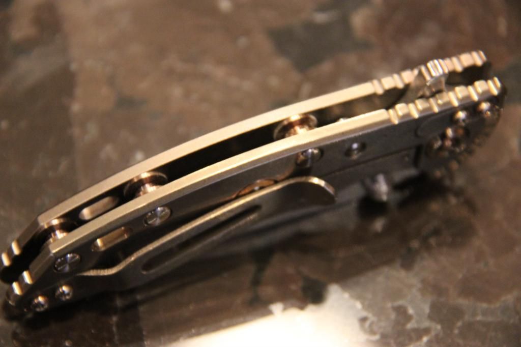

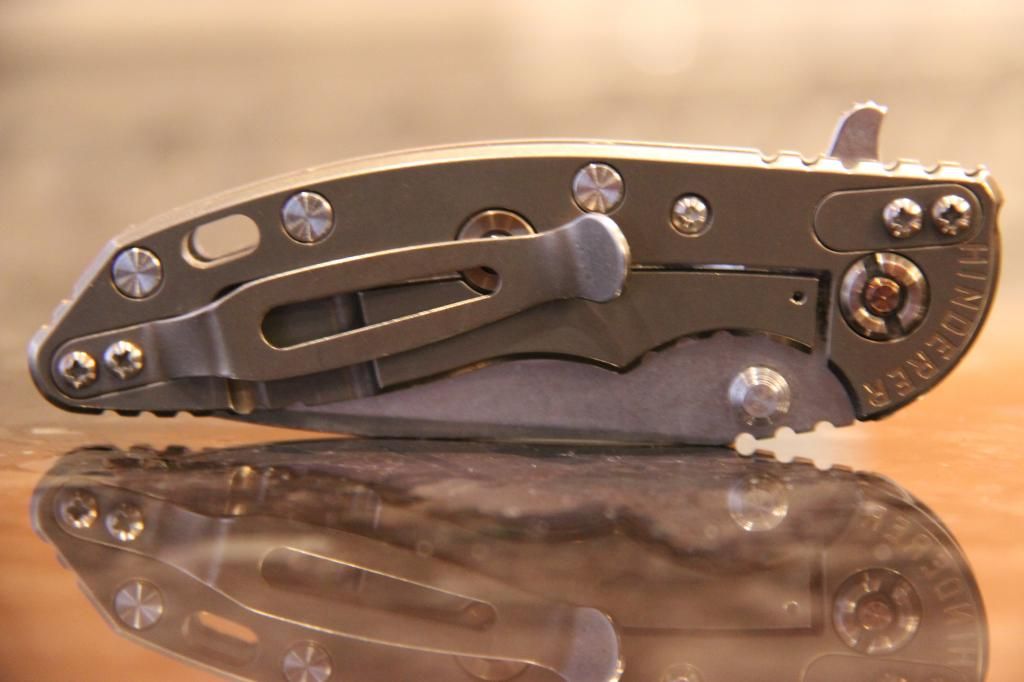

Please excuse the crappy pics......they are meant to give you a visual.......the standoffs should basically be flush with the edges of the liner/scale and lockside......you should not be able to see them when looking straight across.......
That said......I've never tried putting 3.5 standoffs on a 3".......I assume it would look different......but that's really the only thing I can think of since the stop pin should make it impossible for your blade to make contact with the standoffs.......
That's basically what mine look like.
