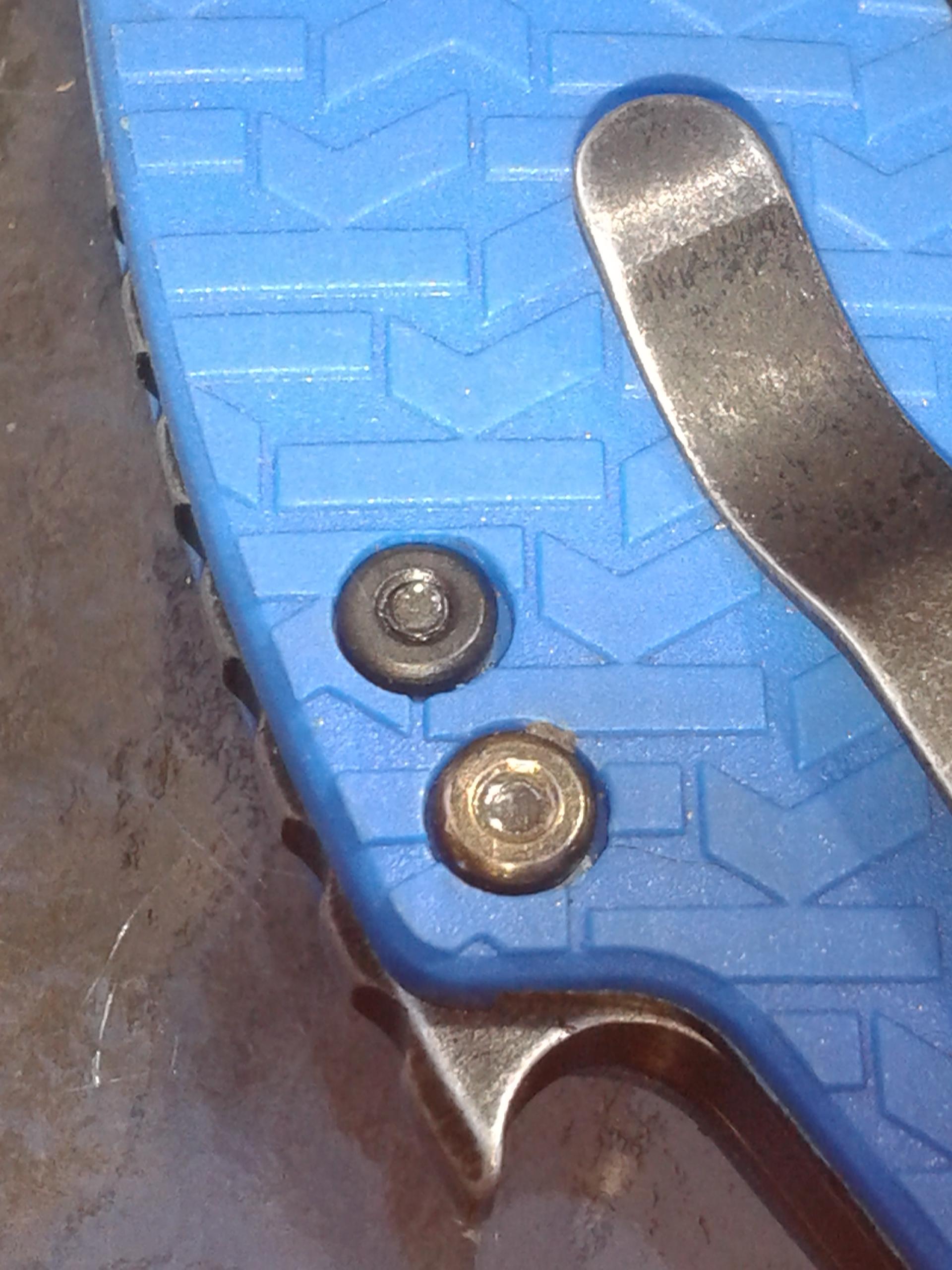

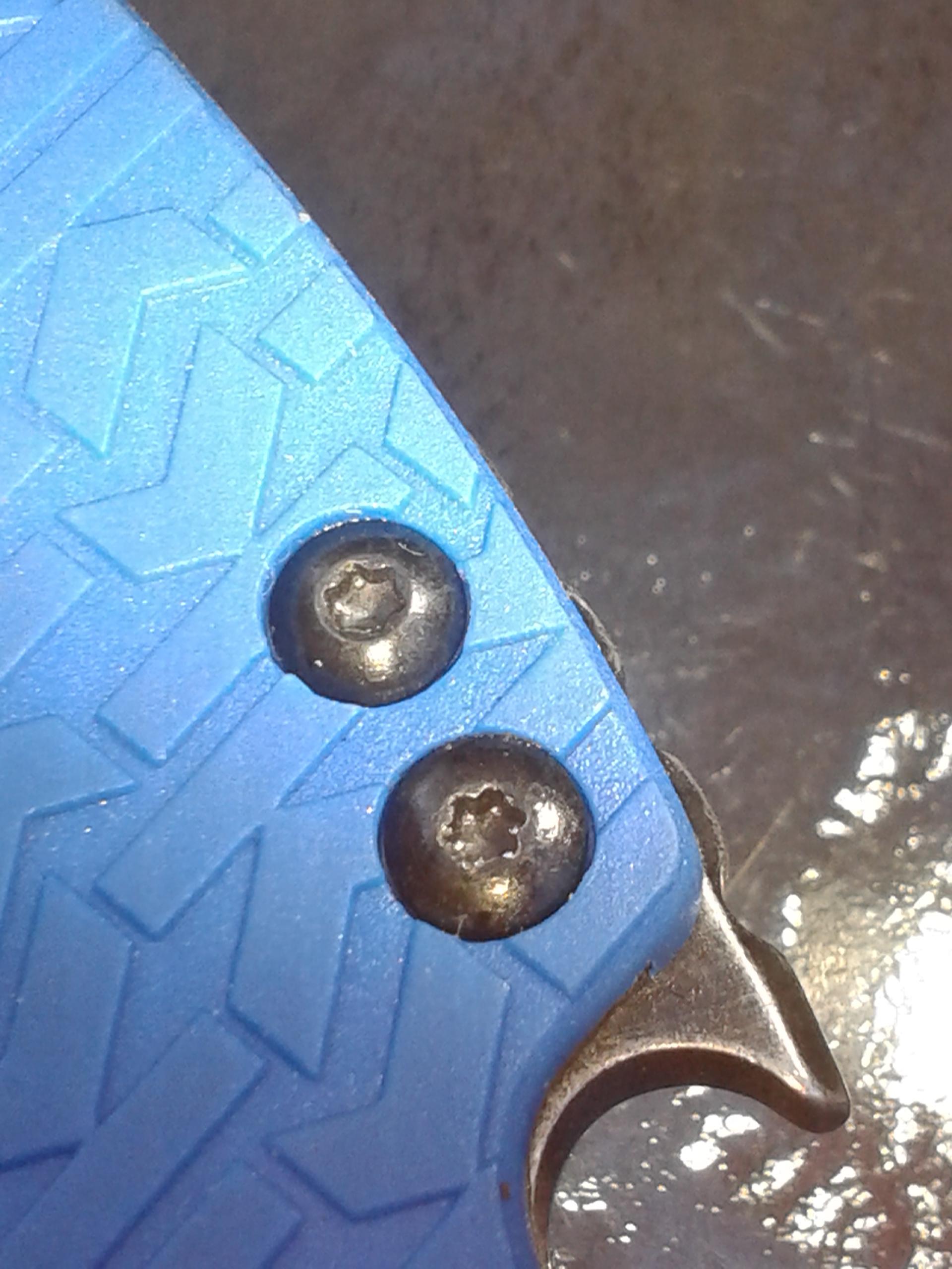

Thanks for the replies guys. When I tried unscrewing them, both sides were turning. So it seems to make sense that I would need to use two keys, however, the side opposite the screw head has no pattern of any sort to use a key with. :confused: It looks almost like a small washer that is threaded onto the end of the screw. I'll see if I can upload a closeup photo to give a picture of what I'm describing.

The first photo on top is the screw head side.
The second photo on the bottom is the opposite side.
It seems that there isn't a way to keep that bottom end from endlessly spinning. :(
They aren't made to be taken apart. The screws are for assembly, not disassembly.
It been a while since I had a Shuffle, but I may have a solution. Generally, I can get the bolt out by pressing a pencil eraser to the "nut" side, to hold it in place with friction, while turning the bolt with your bit or driver. If it is really tight, I put the pencil in a bench vise with the eraser pointing up. Then press the knife down on the eraser while turning the bolt.

You by chance watch the video? (I actually didn't watch the whole thing, but it looked like he addressed the "washer" side somehow...). In addition to what bralexander said... it also works sometimes to wedge something between the handle sides on the inside if you can, (something soft like a piece of wood)... this will apply pressure on the back side of the nut to keep it from turning.

Believe it or not, I did try using a pencil to hold the "bolt" side without much luck, but I was attempting it without a vise. I don't have a bench vise, but I might be able to rig something with my C-clamp. I'll definitely see if I can give it a try. :)
