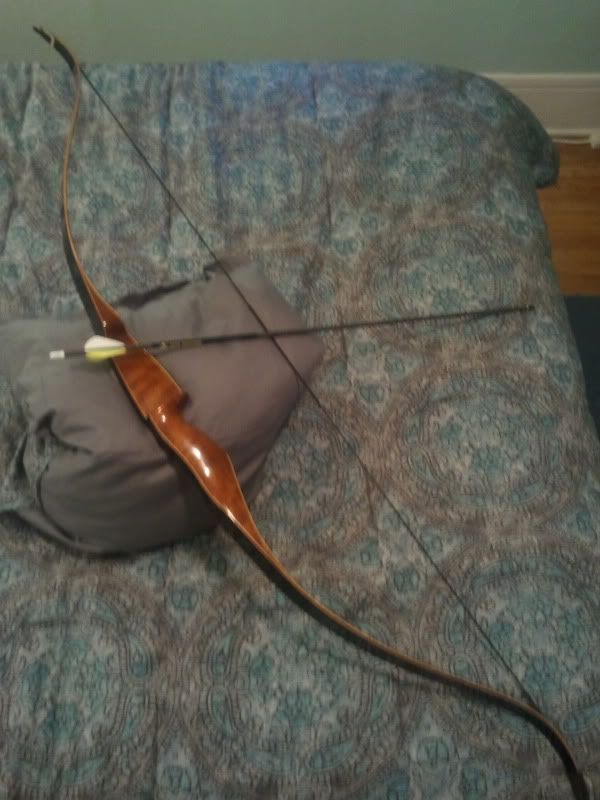

I shoot a recurve, 50#@28" and I have a just over 29" draw, so probably around 53#. I'm shooting 400 spine carbon arrows, 30" long and getting ok flight with 100gr field points. I know how I need to change my arrows for best flight, but I'm doing ok with them as is. I figure technique and practice will do more good than throwing money at it right now.
Now I am looking for a broad head that will be suitable for pig, cut on contact fixed blade design. I don't archery hunt for deer, so that's not a concern. Max range for pig will be 20 yards.
What do y'all like and use? Why?

Beautiful bow. ACME makes a quiver that will attach to your bow from the limbs. As well as taking some vibration out, it will give you a way to hold your arrows without making lots of noise. http://www.ebay.com/itm/Vintage-Acme-Kwikee-Kwiver-Recurve-Compound-Bow-4-Arrow-Quiver-/370949841094
I have one on mine, but it attaches to the sight mounts on my recurve. It is nice to see someone getting back to the basics. Archery is a lost art.
Bear archery is good stuff. I started on a Bear compound. Brings back memories. Folks will say that plastic fletching on arrows (for traditional rest recurves or longbows) makes them inaccurate because the vane elevates and the fletching works as a ramp.... but that is complete garbage for the average shooter. I shot leagues and used to shoot a one foot group from twenty five yards with mine with no sight, just a kisser button. It all comes down to preference and what you like. Is your bow a bear or martin? Martin archery makes some amazing traditional. My father has a white black widow from his younger years when he shot leagues. Nice to see someone is still shooting.
