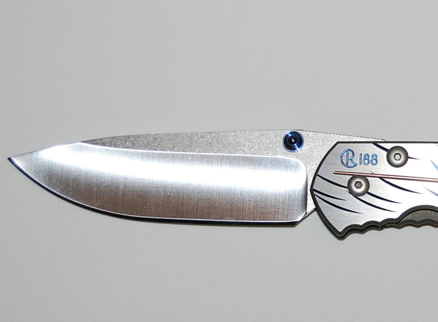

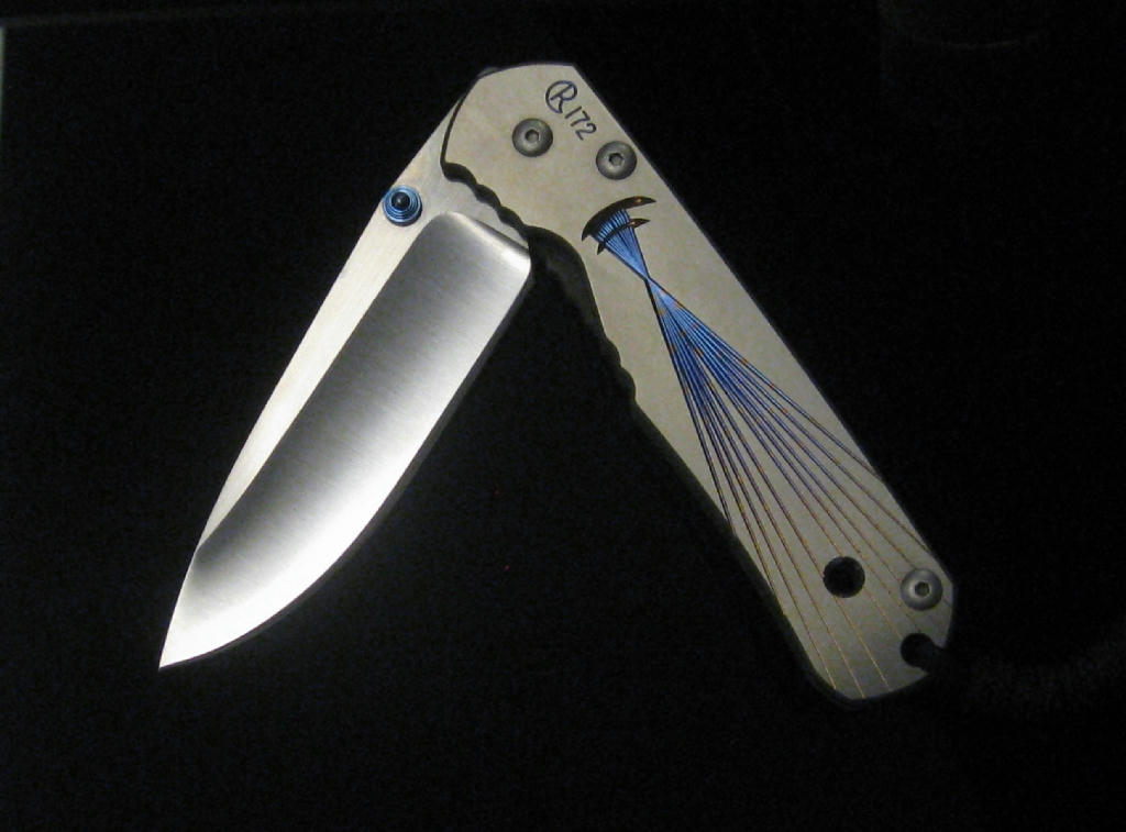

NP. In the period 1995-1997 Chris was working with different blade treatments. The original Sebenza's had polished hollows and satin finished flats, but that gave way to stonewashed flats and polished hollows on the graphic and inlay models later on. He even tried a couple of bead-blasted versions, that those were short lived.
You can see the different experiments with these two. #172 has the satin finished flats and #188 has the stonewashed flats.
There were a lot of variations among these "transitional" models, which makes collecting them so interesting. Great catch with this one!
