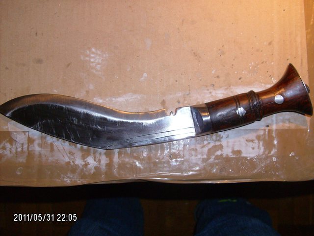

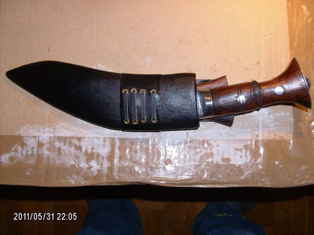

This is the item.
I decided that this had a nice weight and looked workable enough. So I brought it.
The kukri itself

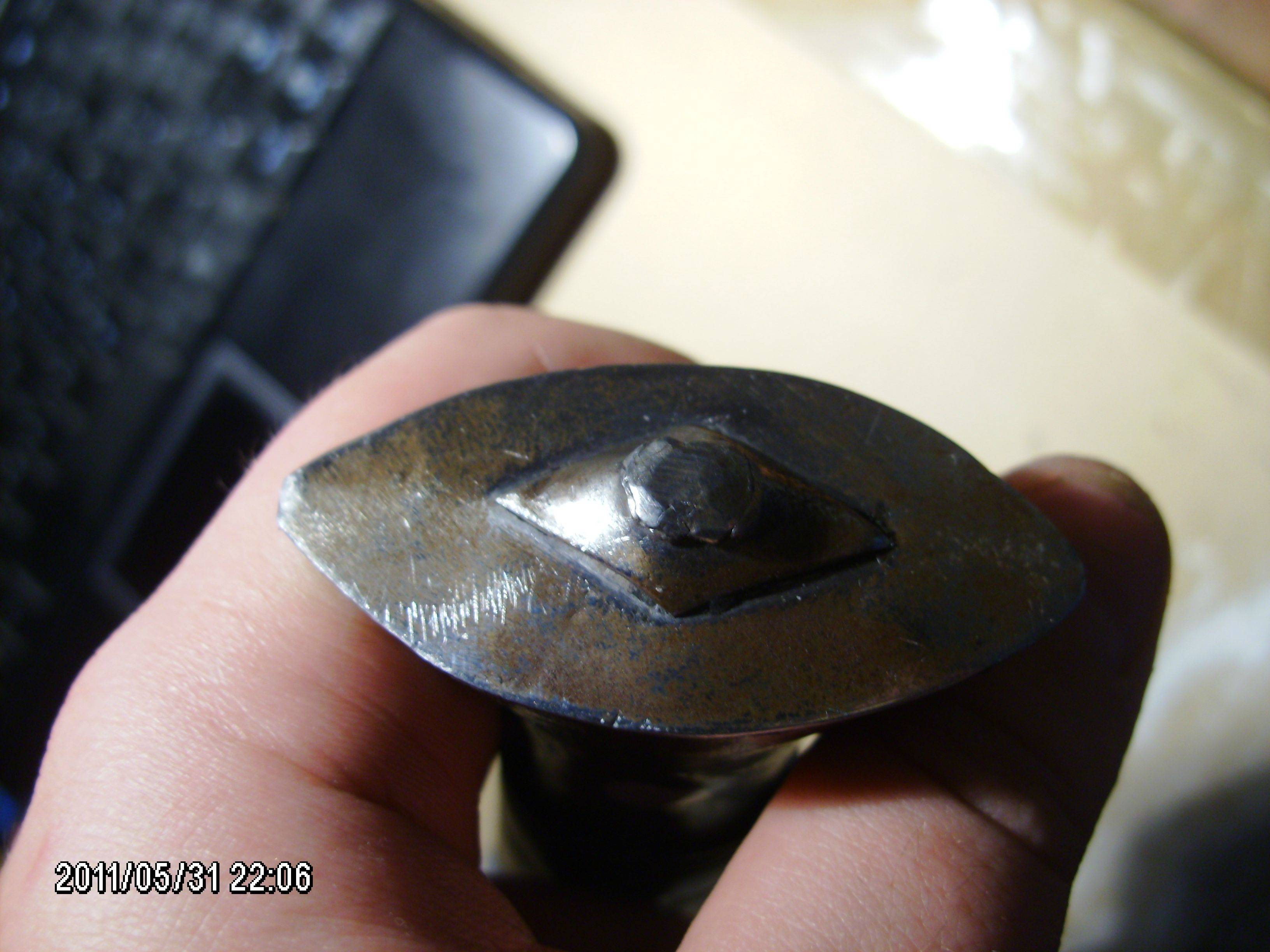

While sharpening, I notice that the buttcap is a little bigger than it ought to be as it cuts into my hand while using it. I decided to simply file it down.
The buttcap itself is a bit worrying, seen here. There are what I think to be rust marks. I simply thought that I could merely sand them down.

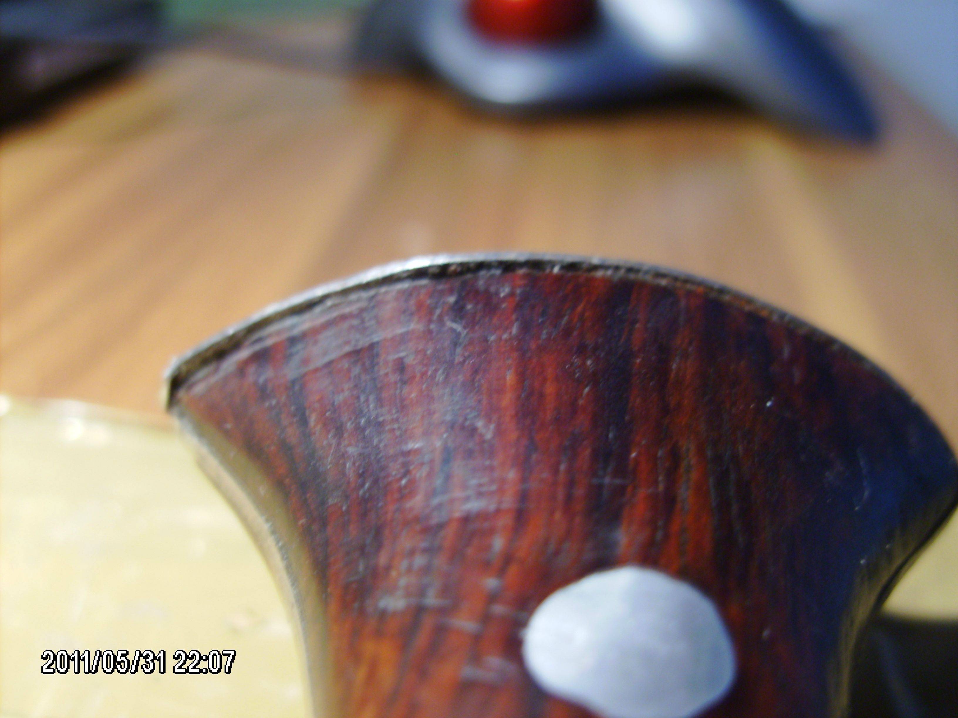

However, while working on it, I examined the other side and noticed that the buttcap wasn't covering enough.
I take my hammer to it, gently tapping it and find out the buttcap wasn't hammered on it right!

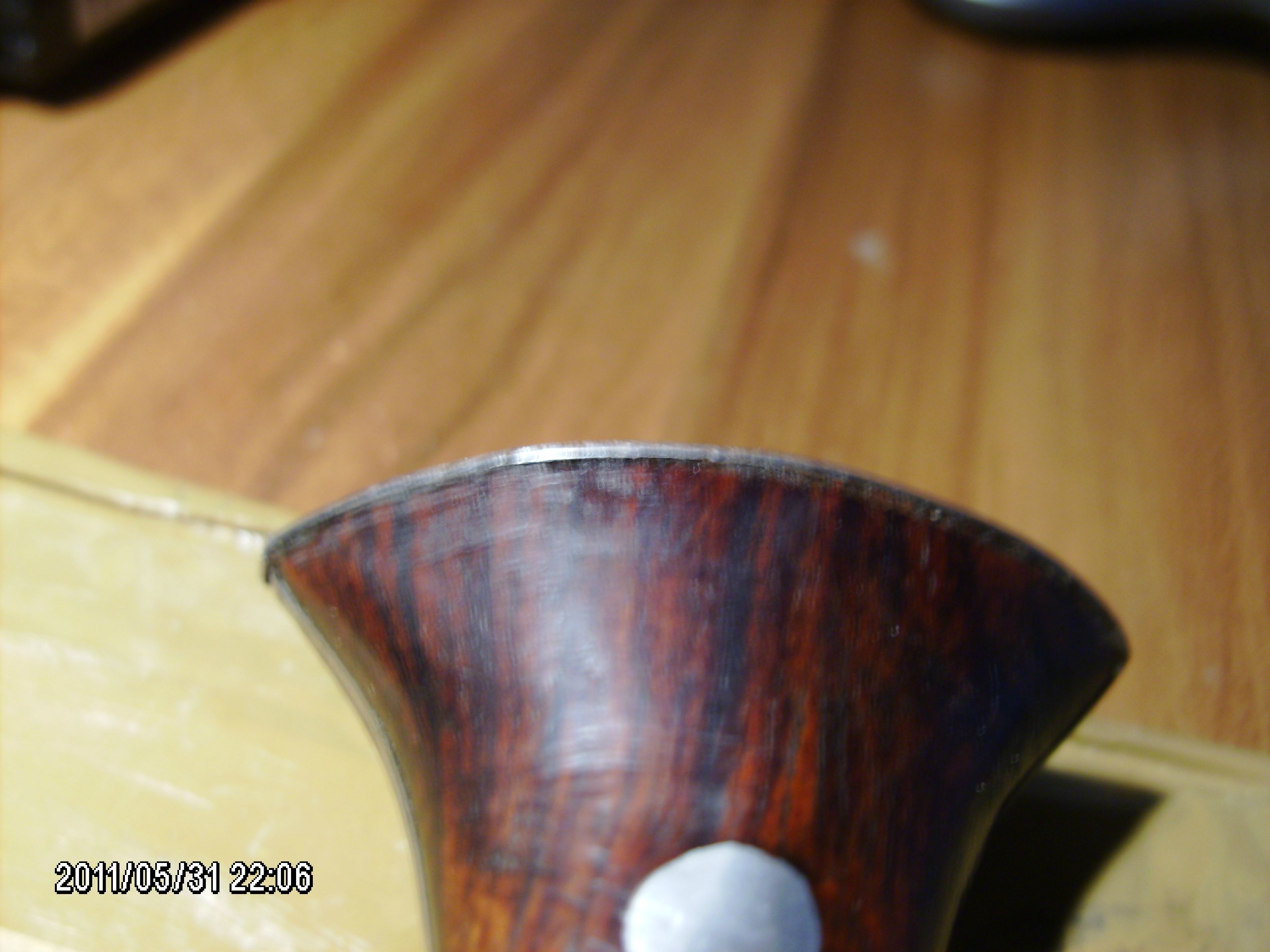

Look here, this is the proper position:
And this is when I move the buttcap (by hand! not with the hammer)
As you can clearly see, the buttcap is lose.
Question is: what do I do? How do the kamis put the buttcap on and how should I do it? Should I take a hammer to it or use glue? Should I take it to a knife-maker (I know a grinder nearby).

Buttcaps on chiruwa/slab style handles can sometimes be loose because they really don't do much other than protect the bottom of the wood from getting dinged up. if the steel is soft enough, you can try smacking it a few times with a hammer to try and peen it out a bit more. You could also try to squirt some two ton epoxy under there and see if that holds it.

There are two things you can do:
1) Heat the buttcap to soften the laha and affix the buttcap back in place. Then slightly peen it tight again.
2) use the more viscous super glue and get it under the cap to remelt whatever laha is there and provide more adhesive in case there isnt enough laha there. Then slightly peen it tight again.
This will probably require a little cleanup or sanding.
EDIT: glue should be used before peening and all sanding and filing should be done by hand.

The tang end that pokes thru the buttcap. It needs to be mushroomed over a little more.
I do it with a punch that is the same diameter of the end of the tang and carefully mushroom the end over so as not to damage the keeper or buttcap.

Okay, I think I messed up when I took a whack at it.
I tried heating it up with a pen-heater. I have doubts that there was enough laha between the handle and buttcap, but if there was, I think I might have beaten it out.
Now the buttcap is uglier, one of the diamond points of the keeper is flat and if anything, the buttcap is more lose.

Unfortunately the fix for it now is not easy, unless you can just get some glue under the buttcap and keeper.
If you can't get glue under them, you will have to grind/file off the peened end. Then remove both keeper and buttcap. And then you will have to remove some material from the end of the handle to give you enough tang to peen over again. Then glue cap and keeper down properly and re-peen the tang end again. It is alot of work.
Since it's chiruwa (full tang) and the peened end is just holding the buttcap in place (instead of holding the handle in place), I would grind or file off the peening, take off the buttplate and keeper and maybe try to hammer out the dents, and then epoxy the buttplate and keeper back into place. I'd skip the re-peening if it involves shortening the handle, since I think that epoxy would be sufficient.
I took it to the local grinder. He managed to hammer it mostly back into place (it still moves slightly). He said that it was Chinese copy, hence why he did it for free.
