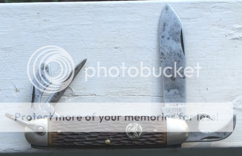

Here's a few to look at. They all don't have the brown handles, but good for reference purposes...
I don't have a pic handy of the Ulster, which is probably more close to the one you are thinking of, and has a round boy scout shield.
Glenn

Ulster USA started making issue BSA knives in 1962. The knife illustrated was issue during 1983-88. It's supposed to look like stag bone.
