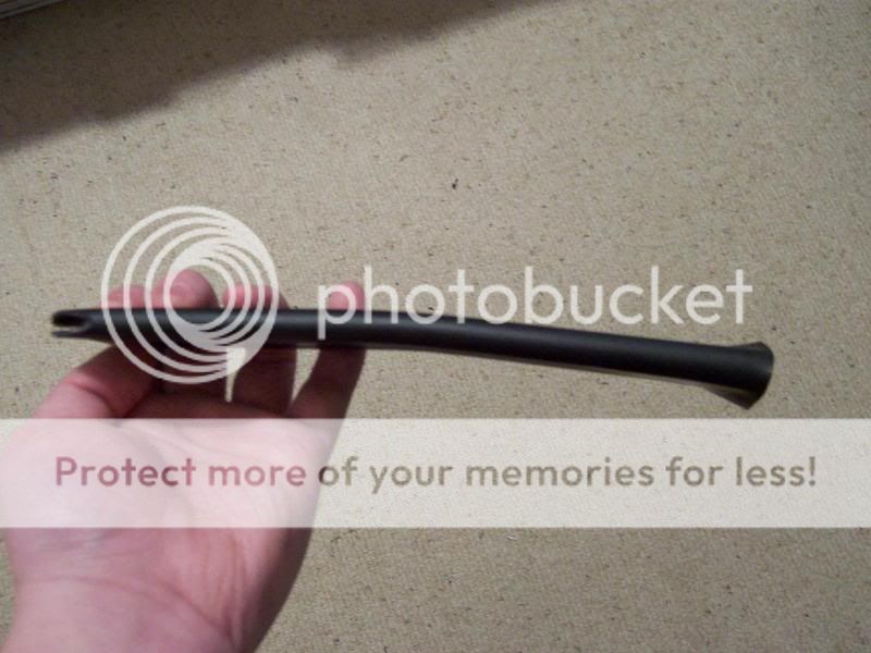

Nabbed myself a spec ops not too long ago. I agree that the inserts are a real pain; I'm wondering if they always come warped like so:
Yes, they make them that way intentionally. Heat it up with a hair dryer, making sure not to heat it too much. It'll bend straight.

here's what mine looked like for reference
