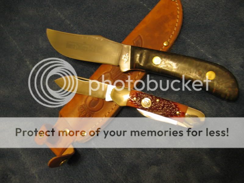

Here is a pic of my Queen D2 skinning knife, along with it's Queen D2 Canoe partner. They both are great knives, with great steel.
