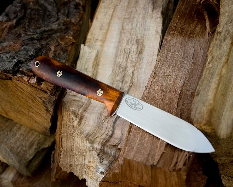

Need help with a sheath style
Dec 11, 2006
1,659
Because every maker out there has a "Kephart" style, I have avoided making one of my own. But, a recent trip to the Smokey Mountains, and reading about Horace's time there has changed my mind :D
So, I made up a Kephart style blade, and now it is just sitting here. I could just quickly do a "foldover" style sheath for it, but it just isn't sitting right with me. The idea doesn't seem to "fit" the knife.
Any thoughts? Anyone have a Kephart-ish style knife that they have a sheath they are particularly fond of?
Your input is appreciated.

Beautiful knife, I really like your style of blade profiles.

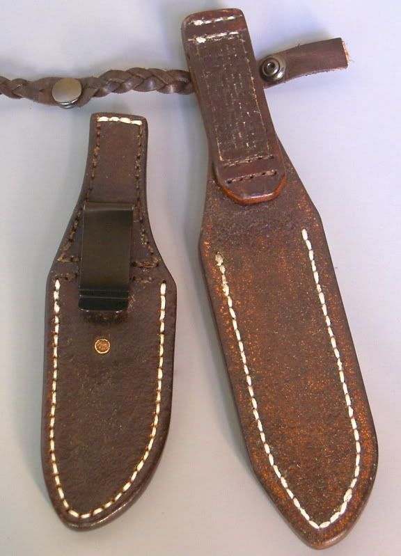

I don’t think a fold over or pouch style catches the era of the Kephart either. For mine I wanted a cleaner line than the cheaper looking belt slot style like the original.
After doing the mod on Gossman’s raw blade I came up with this style for the Kephart and did the second one for an old Sharpfinger with the thought of adding it as a piggyback. The belt loop on the back is spaced with a layer of leather.
Looking forward to see what folks come up with compared to my homemade version.

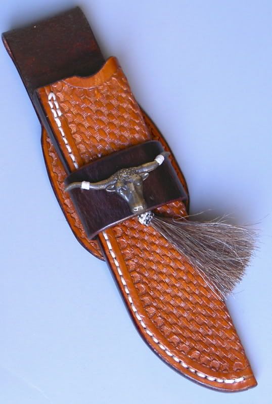

David Wesner at Kelsey Creek Knife Works made a kephart for me that I love. I thought about a period style sheath but went with Davids sheath that is sewn around all sides.
The syle can be seen on his website.

The one that Ramm9 made is certainly period accurate (perhaps minus the basket weave) and looks great.

This is, BTW, some of your best work yet. I KNOW everyone has a Kephart - but your design speaks of your tweaks and you did it very well. There is NO reason not to add this to your stable.

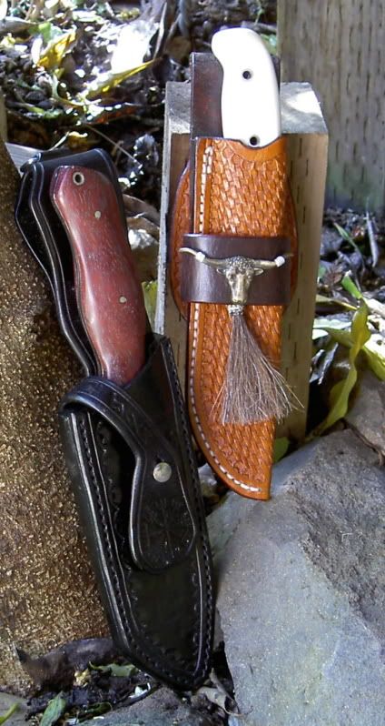

Brian, if a client turned me loose with a knife exactly like yours, it would wind up in a fitted, fully lined sheath styled similarly to the one Tal pictured in his post.
You knife seems ideally suited for the deep seat pouch style.

I would go with something like these
You could fold it over or sew both sides and add a bit of western flair using a Mexican Loop. Lined with some deer hide showing would be very classy.

The knife is extremely well suited to that style of sheath but as a result everybody and his brother is using the same style sheath for that knife and most other "bushcraft" blades. When you are building for re-sale maybe it makes sense to do that since it's suited and keeps the costs within reason but something a touch different than all the others would be refreshing...but may not make sense economically.
sheathmaker, do you have a photo along the lines of what you have in mind?
Photo as requested is below. The OP knife has no guard or anything with which to make a retention strap useable, so the logical step from there is deep seat. A blade type sheath (stacked like a sandwich and stitched all the way around) could be made but it would still have to be deep seat to prevent loss. Last, the tricky designs and add this or that, just don't go with this style knife. Let's face it, the Kephart is kind of a bland , no nonsense, utility style knife and the more simple style sheaths just go better with it.
Thanks for posting those, that style does look ideal for the Kephart.
