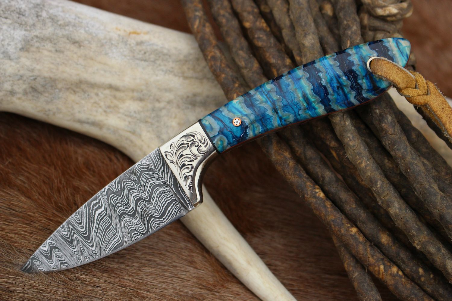

Not often I disagree with Stacy...... perhaps not everyone's taste but mediocre...not so much... The knife that produced the scrap for the Tapadero.
I have hundreds of knives out with mammoth tooth in them, either whole handles or spacers. I very seldom get any back for repairs, and it is one of my most often requested materials. The material is not for everybody but it can be worked and made into an attractive, durable handle. Particular methods of workmanship and styles of knives are better suited for mammoth tooth than others.
