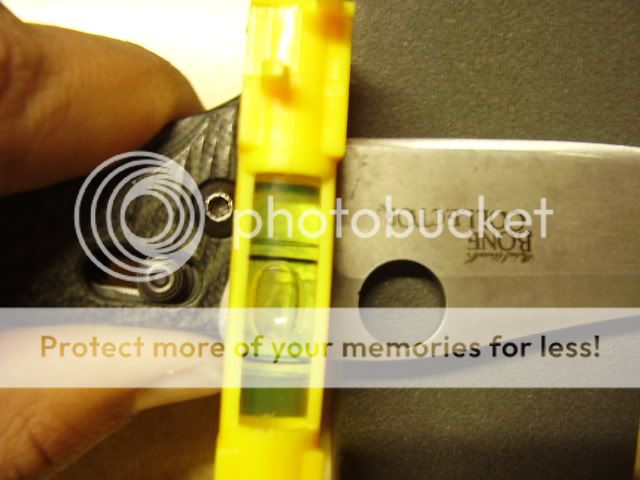

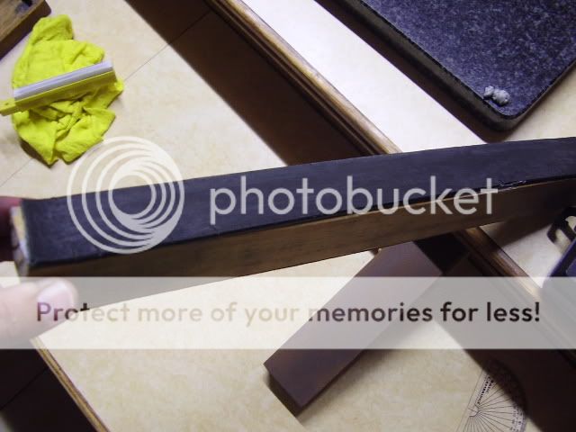

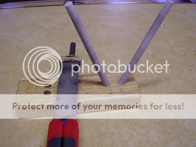

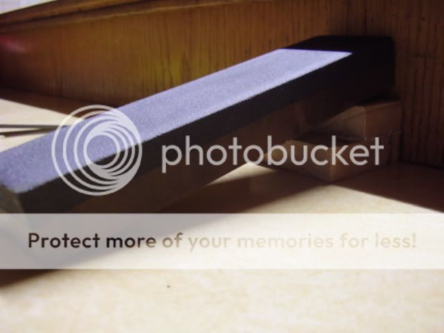

Well here is my process and my simple tools. With a good set of diamond stones, time and effort to learn you can get great results!

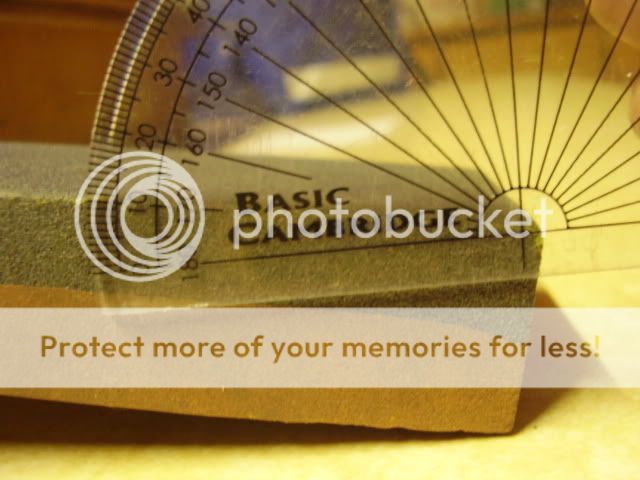

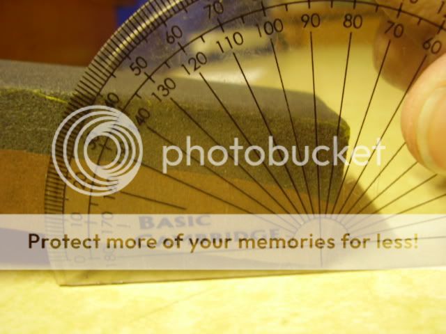

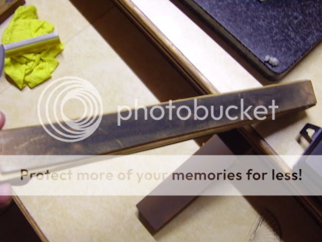

I recently noticed while playing with the benchstone and a piece of plank that it seemed to be a good angle at around 5 degrees. After some measurement this is what I came up with:
Now the reason for this is due to a video done by another member on various forums.
Here is a link to his great adjustable sharpening platform:
http://www.youtube.com/watch?v=AXhrqfV5jvs
My method is very similar, except after watching videos of the Bubble Jig
http://www.youtube.com/watch?feature=player_embedded&v=Jp5NLNmMe2Y
I decided to incorporate something similar till I can afford the real Bubble Jig.

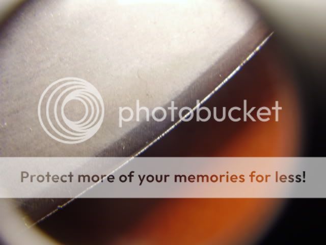

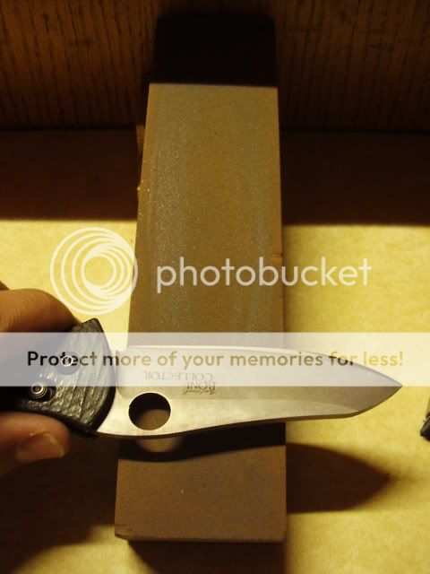

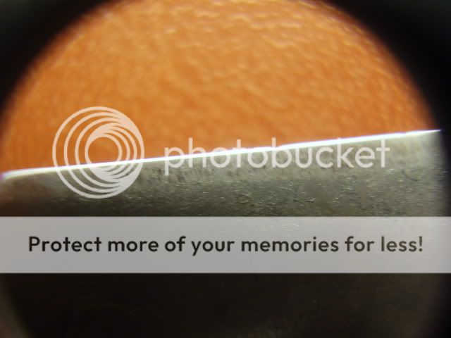

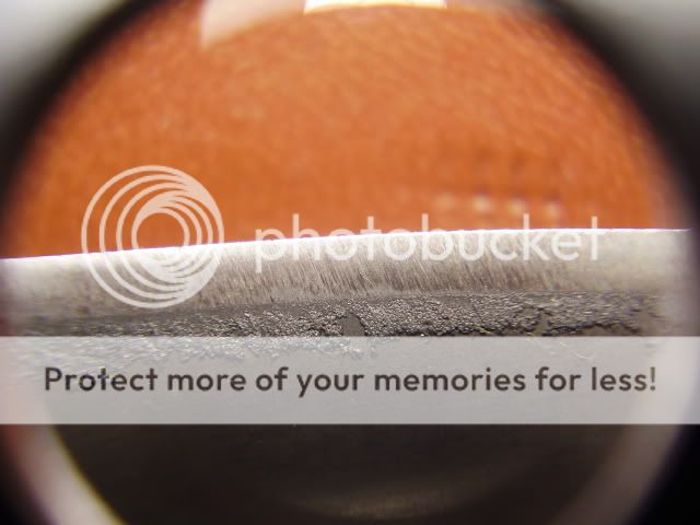

The secret is to get a good burr going. This is D2 steel on my Becnhmade Bone Collector profiled to 10 degrees per side.
Good burr

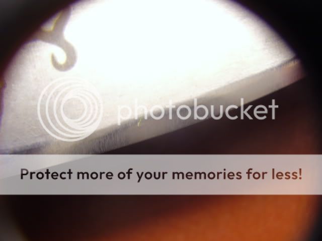

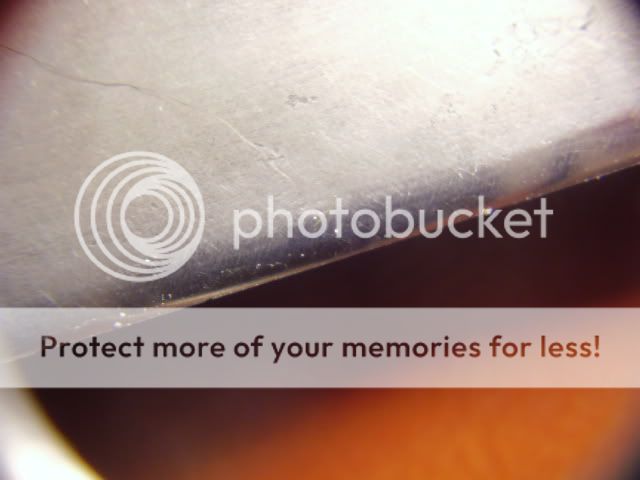

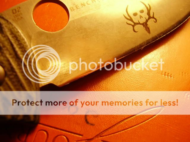

Edge all the way sharpened
No burr, and not hitting the entire edge: BAD!

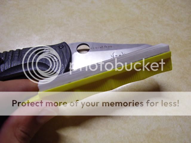

Then I knock the burr of with white ceramic stone of Lansky

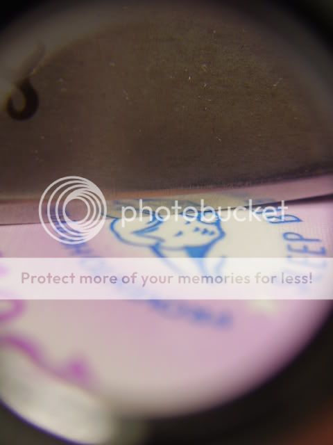

Then strop.

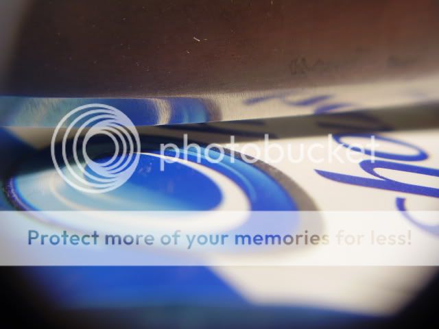

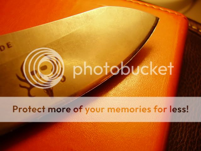

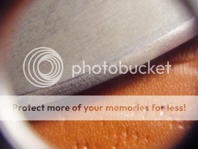

Results
Under 25X times magnification
In the field I use a diamond paddle 600 grit or Lansky Turn box kit. Usually I just use the paddle and lightly knock the bur off.
Total edge reprofiling: Can take up to 2 hours.
Edge maintenance. Less then 10 minutes to same results as above. In the field the same time. (this can vary depending on the damage to the edge and DONT STOP UNTIL YOU FEEL THE BURR)
