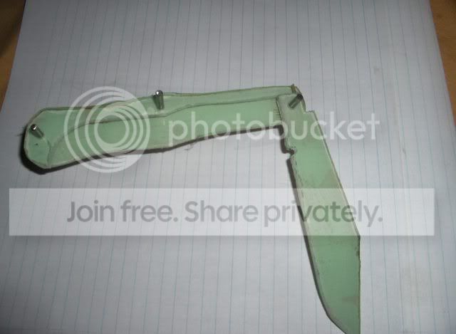

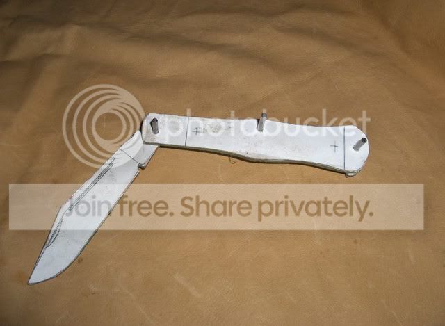

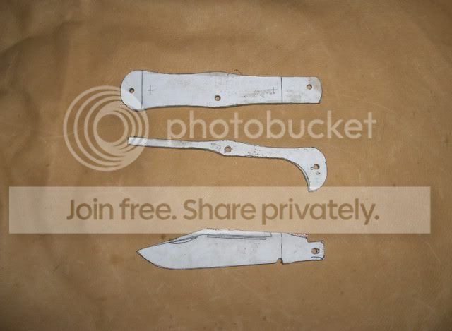

Chris's instructions are pretty good but he uses an existing folder for a pattern, email me and I have a couple I can share. My best advice is to make a plastic model first, this really helps you understand how a slipjoint works and lets you work out fitting issues, these is from 1/8 micarta and it opens and closes like a real slipjoint.
