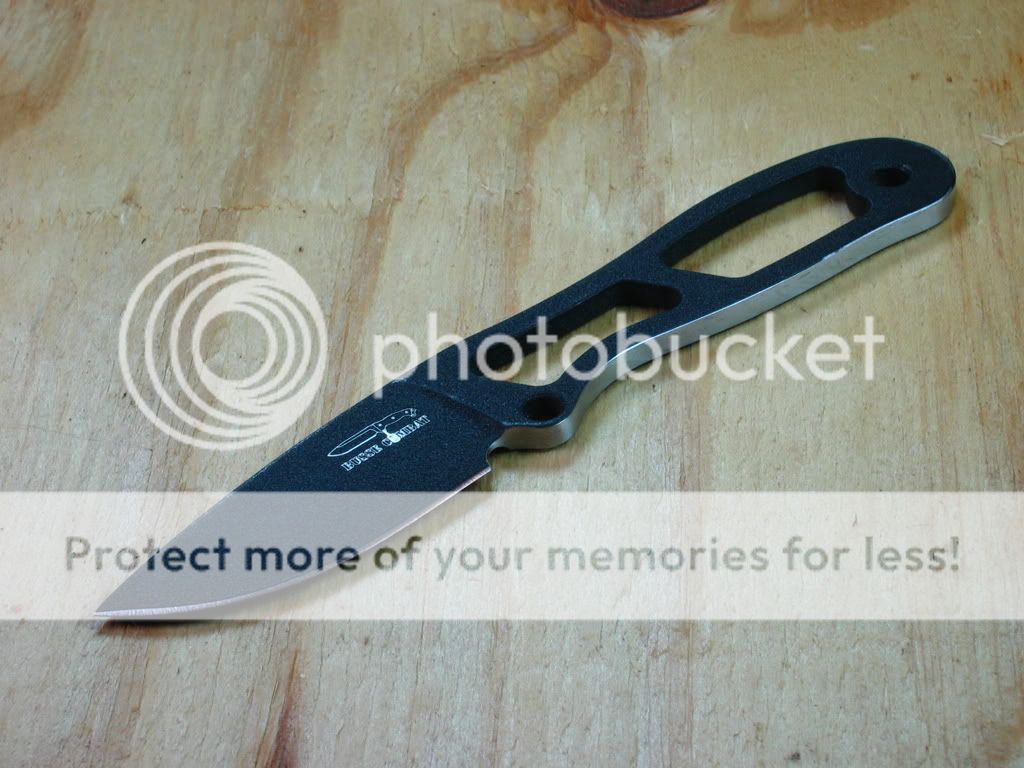

Yep, handle profile is the same as a reg Warden. Here's some badly-lit pics of mine just after I polished the spine. It was a user from day one, so the coating was already a little beat up, but it looks kinda cool with a nekkid spine.

BTW-Greg, that polished spine is sweet:thumbup:

I agree--that polished spine looks VERY nice. May I ask how you did that???

Thanks, and it was nothing fancy at all - just started with some 80 grit sandpaper layed out flat on a work table and started rubbing the spine back and forth over it. As long as you keep the blade fairly straight up and down, this way makes it pretty hard to screw up and gives you a nice, clean edge where the spine meets the sides. The 80 gr took the coating off really well, and from there I think I went to 120 gr, then 220, then 400, then 600, which was as fine as I had at the time.
The choil and other curved areas were the hardest part, but it wasn't that bad. I wrapped the sandpaper around a screwdriver to keep it squared up. Also, I tried not to spend too long in one place to avoid a possible flat spot. If I was doing it over (or it wasn't a user), I'd spend more time with the courser grits to make sure it was smooth. After it started getting more polished, you could see slight grind marks in it.

i might polish the spine. so after the 600 what do you do or is that it?

...Now you know why they call me "Mr. 27", LOL. :o:D ...On mine, I went up to 1500 grit for the high-polished look on the spine.
