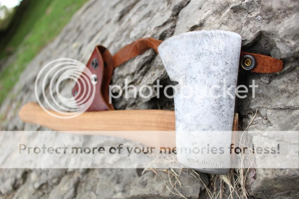

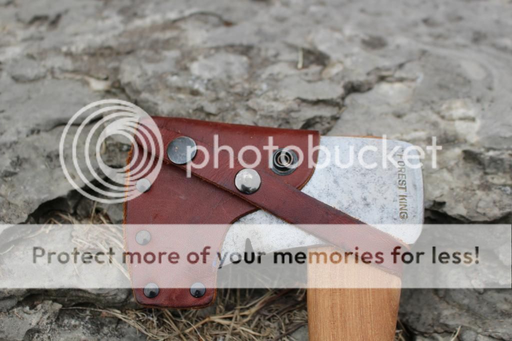

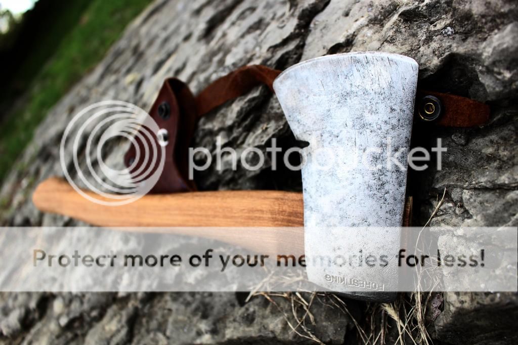

Picked this up at the flea market today, I never have collected axe's or hatchets but Have read all you guy's threads and thought to myself if i ever see an old one for sale somewhere I am gonna pick it up. Well today I went to the local flea market and this one came home with me. Any info or value on this piece would be greatly appreciated. Thanks all!
here are the after photos. Hope you all enjoy. I know I enjoyed bringing it back to life.
Don't know a thing about it, but I'd have done just like you and jumped all over it. :D
It's a nice hatchet. I'd say it's worth $10-$15. I would hope to buy it at a flea market for $5 or less.
I like your flea market hatchet. I would be happy if that came home with me. I would put a new edge on it and clean up the mushrooming on the poll. Well I would clean up the handle too but not too much because that one looks to be in pretty good shape.
Have fun with it and beware that it can all start with a hatchet.

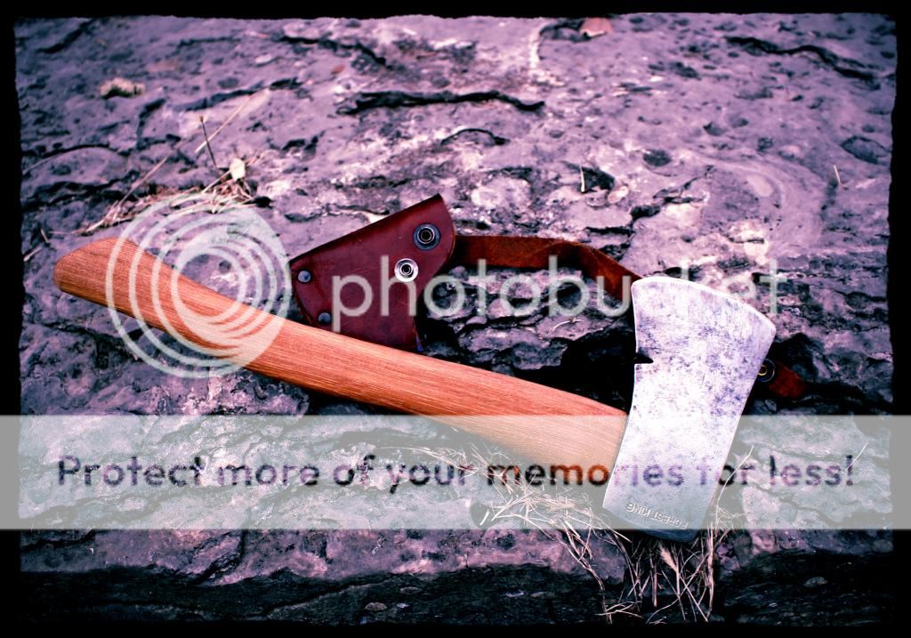

Well its been a While but I cleaned up the mushrooming, tried my best to clean up the edge and get most of the chips out, And I rehandled it because the head started to come off and there was some cracks in the handle under the head. I will try to get some pictures up soon as this was my first rehandle and I followed a youtube video by wranglerstar and was very happy with the outcome.
I am updating the first post to show how it sits today. It finally got the love it deserved.
