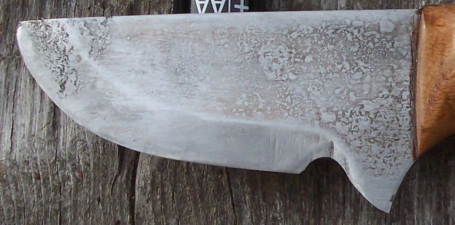

I've been using a charcoal burning, coffee can forge to heat treat the blades I make. It's a coffee can with an air hose going in the bottom blowing up through the burning charcoal. The blower is a hot water heater fan and I make my own charcoal from scrap wood. I am able to get steel to the point where it is no longer magnetic. I'm limited to about a maximum of a four inch blade which is usually not a problem but it would be nice to be able to be able to treat up to a six inch blade now and then. One thing I don't like is that the charcoal causes the surface of the blades to grow bumps and blisters on them. I don't know what it is but it needs to be ground off for a smooth blade. Sometimes I leave it on for an old-time, rugged look, lots of "character".

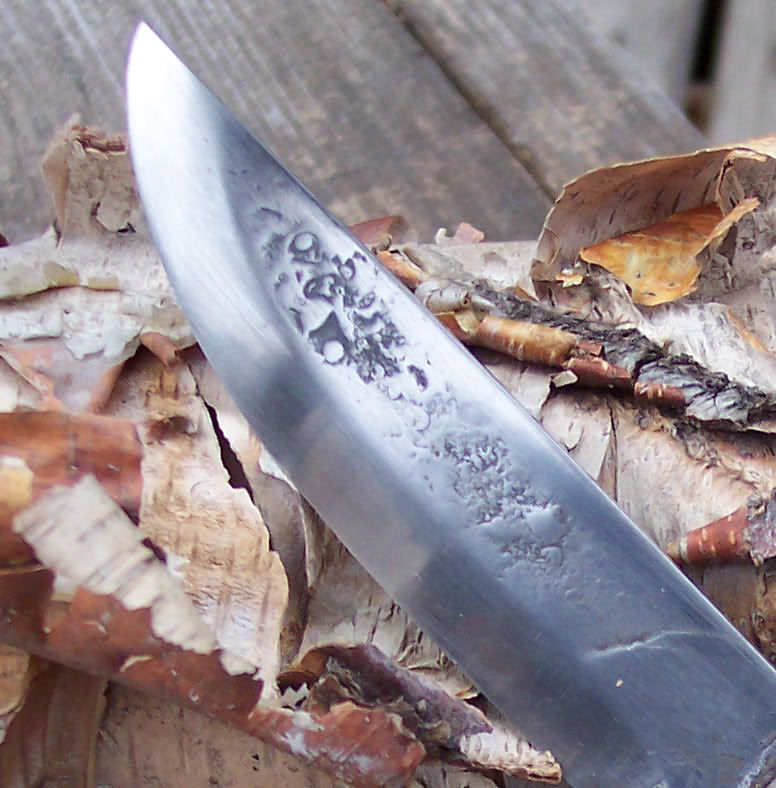

Here is a picture of the bumps/blisters. This is on 1095 steel. It never happened on D2 though.
and another,
I don't know what it is nor what causes it.

I believe the blisters are caused by overheating, you should be able to get the blade to non magnetic without blistering like that.

The blisters are from overheating and scale. A coating of something may help, but better HT methods would be far better.

your surface blisters are either just overheating the surface, or possibly getting surface infusion of carbon (kind of like case hardening) which lowers the melting temperature at the surface where the charcoal then touches the blade and spot overheats it.

You are overheating the steel in an oxygen rich atmosphere = blistered steel.

And, I second the rest of the guys who are telling you that the bubbles are from overheating, and that D2 won't work well at all in a charcoal forge.

LP, I forge and HT with charcoal. Not sure if I am doing things the "correct" way but have turned out some blades that perform surprisingly well under hard use. I agree that your blade looks like it has been too hot. I used to do the same thing, but more is not always better. My forge is made from scrap metal with rebar legs and tool rest. My air supply is a combustion air blower from a gas furnace. By itself the blower puts out WAY too much air so I slow it with a motor speed control. It sounds like you have a similar blower so you may want to look at ways to decrease your air delivery.
For me HT on the forge starts with how the fire is set up. You don't want a new fire, look for the charcoal to be evenly colored and burning well. I form a layer of coals with a U shaped trough in the center. Once happy with the fire setup I start the blower turning slow and add the knife to the center of the trough, edge up. I heat the ricasso area first, watching it closely and checking it with a magnet often. Keep it moving if needed to heat evenly. You are looking for just enough heat, but not too much. I think you will be happier with the way your blades perform if you can avoid overheating during HT.
