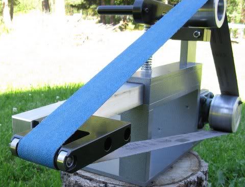

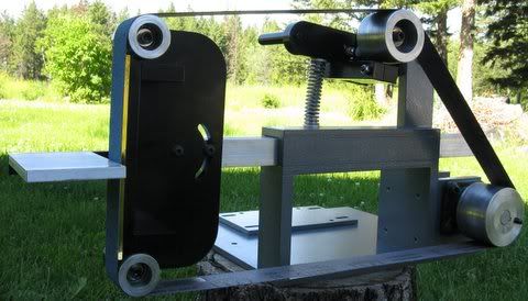

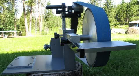

I bought a grinder today and need to know what type of motor I should get. I only have 110 and will up grade the panel to a 20 amp fuse so i can get up to a 1.5 hp with a 15 amp draw . I need to know what phase i need for in the future i want to get a variable speed control. Will a 1hp be enough ill be running a 3 step pulley.I will try to show the grinder i bought.

Who the heck is making that grinder? It looks like a super clean KMG clone. How's it put together, I don't see any bolts or welds?
Looks like a nice machine!
I think Rob is quickly becoming the Loveless of grinder builders. He came up with a good, solid design, and now everybody's copying it. :)
Nick this machine is being sold by the hundreds in france. The guy mills everything no welding zero its sand blasted anodized and powder coat painted. All the pieces are bolted together from underneath. It comes with a 1, 2 and 3 inch wheels 10 inch smooth contact wheel, glass backing platen , small wheel attachment. I had alot of help from alot of people and decided not to build my own and to find the best i could for a good price. very competative to say the least. kellyw
