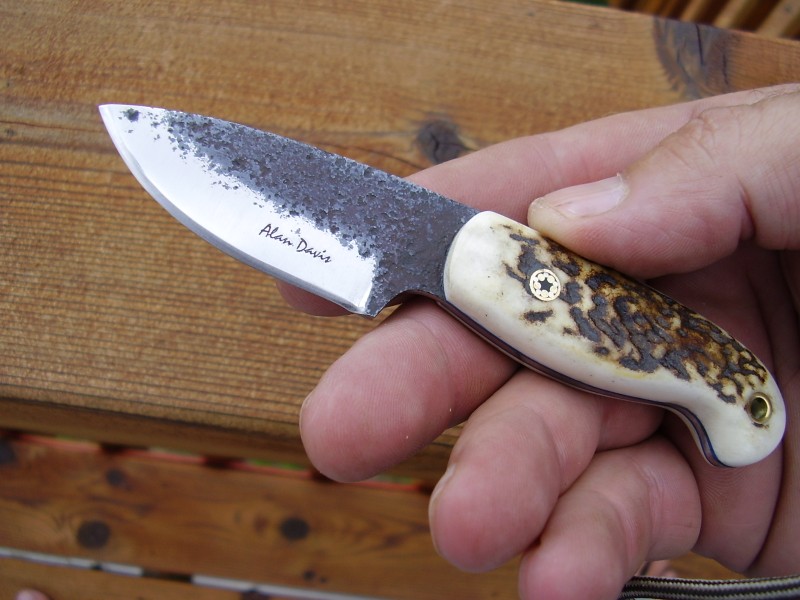

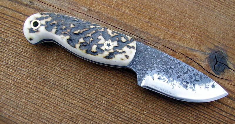

Alan Davis makes his "Misery Whips" out of L6 which are from old saw blades. All I can do is offer my experience with it and it's been a fantastic steel that sharpens very easily to a razor edge and maintains that edge for sometime.
I really don't use it hard due to it's diminutive size but again I really like the steel...
