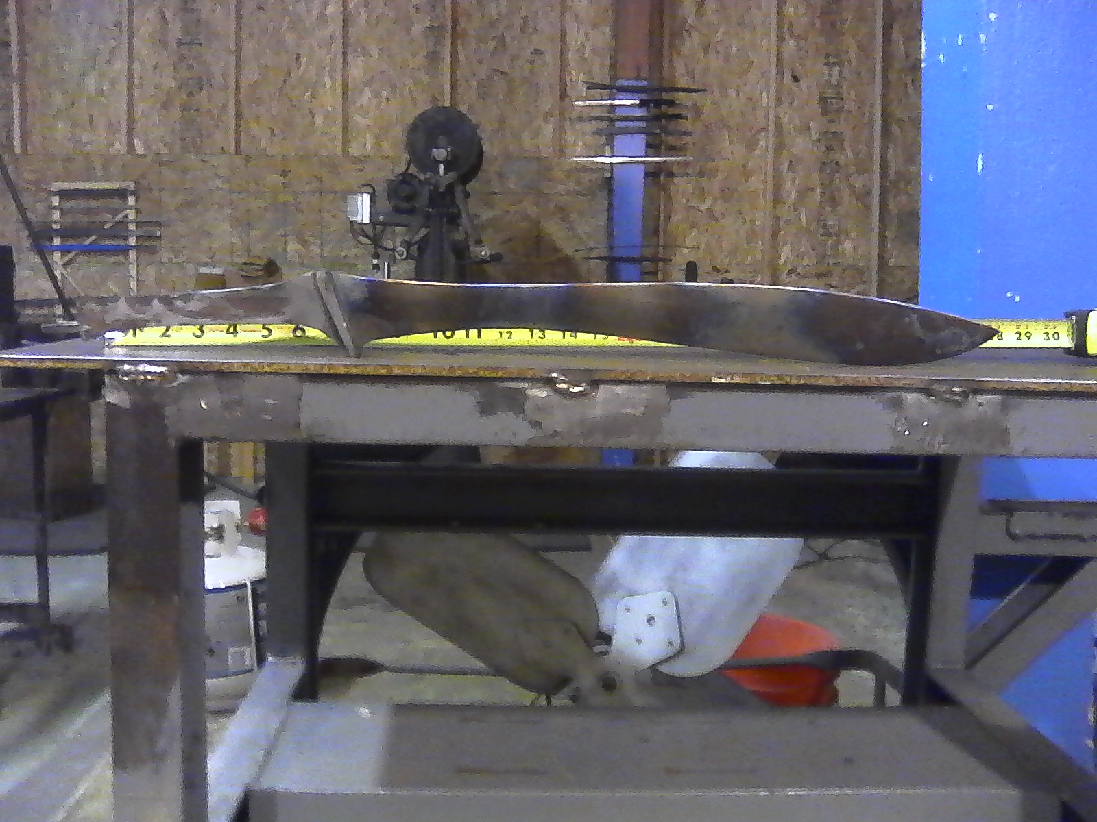

Finishing up a blade right now that's a lot like the one in the movie, minus the long grip. I was calling it a "big round-bellied leaf blade kukri thing," but maybe a "kopis-like object" is more accurate. :D

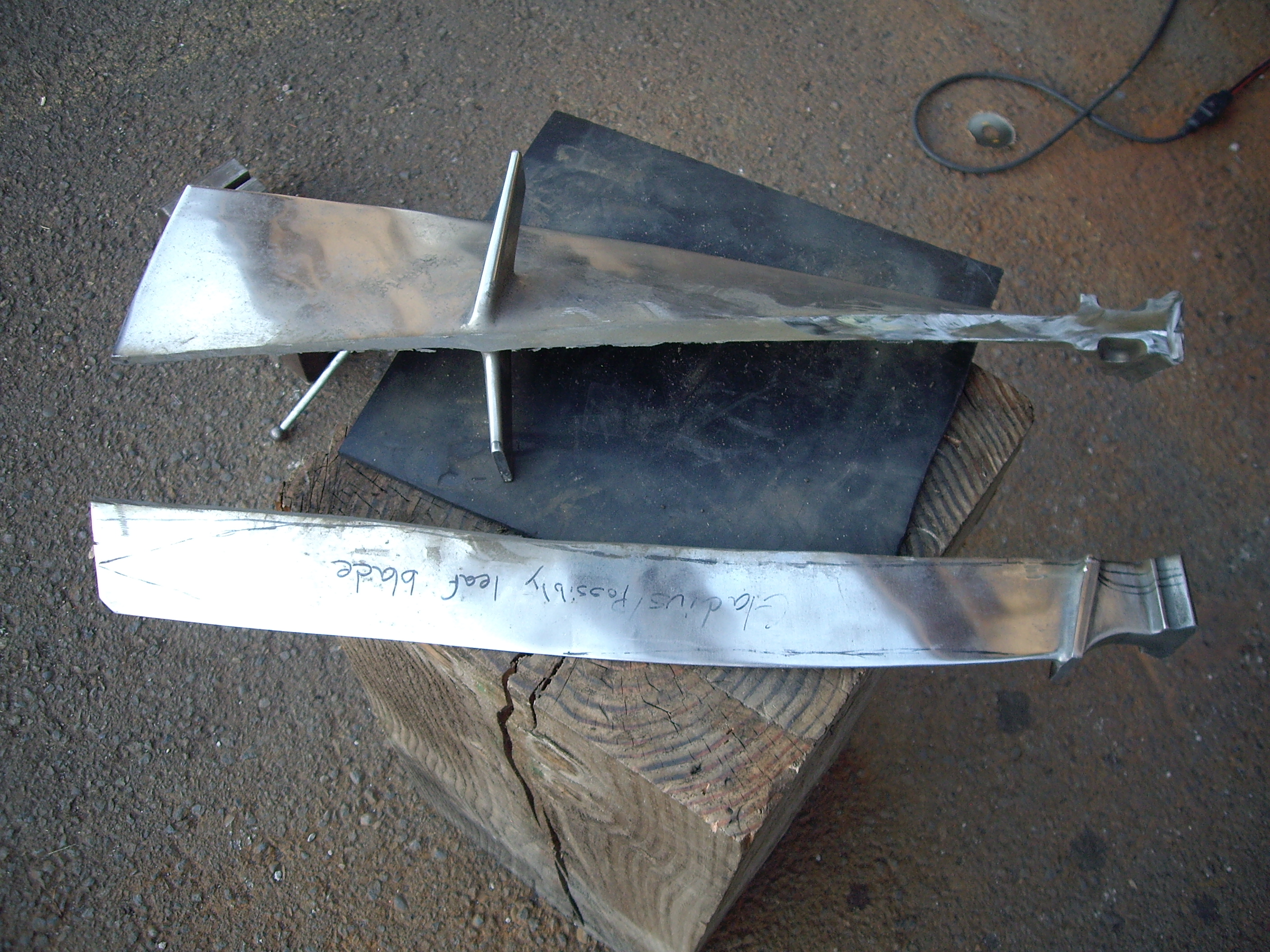

Well, I'll post a sneak peek. Making this blade has been a long, difficult task, and it's almost done. I'll post the whole story up when it's finished soon. It's made from a piece of a turbine blade from a C-5 Galaxy military cargo jet's engine, or was it a B-52? :confused:
It's an alpha-beta titanium alloy that has proven to be very...unusual. :D
