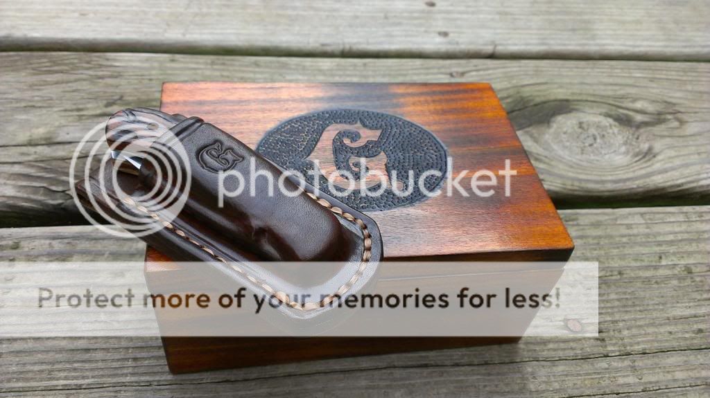

Need some constructive criticism. First folder sheath.
Jun 13, 2007
7,743
Hey guys. It's been quite a while since I made anything for myself. I've been carrying a fixed blade since I made my first sheath and kinda missed my folders, especially the 810 Contego.
Had some scrap leather and decided to give this a go. I'd like your honest criticism mainly because if I ever plan to sell them I need it, but also because it's my first and I need to know where to focus.
In terms of the things you cannot tell by looking... The retention is too strong. I cannot easily retrieve the knife which makes the clip a better choice unless you need pocket space (that's the boat I'm in). The shape seems a bit odd, but it does mostly follow the shape of the knife.
I really should have (re)read the excellent folder sheath thread but I just threw this together. I do like the colors and different threads.
Edit- oh yeah, I have some 4/5oz coming. This stuff is on the thick side of 9oz. The definition, or lack of, is a consequence of the thick leather. :(
I think you hit on the issue, too thick of leather formed too tightly, so it retains it too well, for vertical sheaths I use 7/8 ounce leather is as thick as I'd go. When I first read your problem with strong retention, my first thought was it was sewn too tightly to the contours of the knife, an easy enough thing to think to do, but yours seem ok you don't need to sew to the exact contours, as the leather needs room to stretch as the knife goes in and out.
Other than that looks great, I know you'll have a better time with slightly thinner leather!

The sheath looks good , If I may add some comments all based on what I've learnt here ....
Belt loop - might be too narrow for a tight fit, all the folder sheaths I've created I wear a lot before I deem the design saleable or ready for gifting, wiggling sheaths are not great when you want to get the folding knife out fast with one hand, and a good grip prevents it slipping out of your fingers.
Belt loop is not a flush fit around the belt , Gary's design where you wet fold the loop over a blank piece of belt works a treat, again this helps with tight retention for easy and quick deployment of the knife.
Belt loop is too high (more suited for fixed blades with longer handles), if you apply the wet form process above then your belt loop can be lower, allowing the knife to extrude so it's easy to grab with two fingers
I've used the thicker leather like you have and it worked fine , the wet form is more difficult initially but once it's dried a bit it becomes more pliable, of course one gets different leather and here in Africa our cows are different breeds....no expert but the leather you guys work with is so smooth

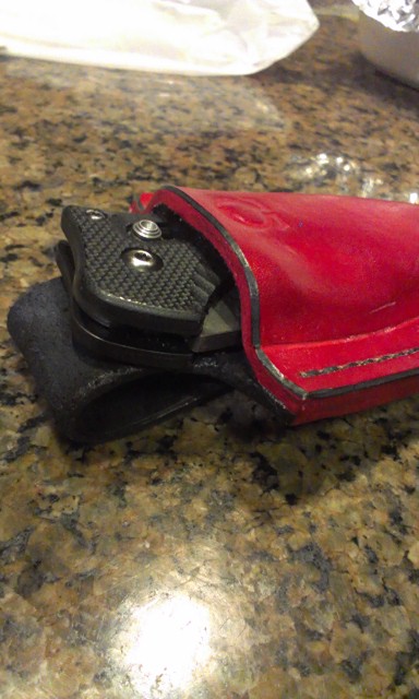

Couldn't stand it. Just didn't work at all.
So...

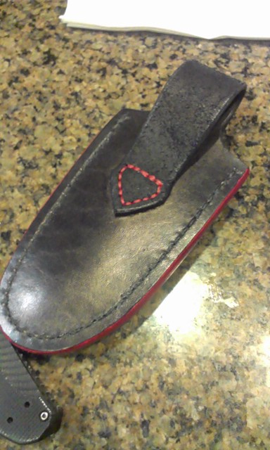

Big thanks to you Elder. It's definitely not the most elegant solution, in fact, I tried to do a couple of different things but this was the best outside of breaking it down all the way. As mentioned, this was an exercise in learning and I learned a lot. It works perfectly well now. Knife draws easily because it's tight on the belt.
Thanks for your help guys. :)
On the contrary Buddy I find it an elegant solution and you carried it out well. There is a perception amongst many that thicker is better, a sign of quality. This is not so. I'd of built this out of 6/7 oz probably. Give your sheath a squirt of silicone spray and you'll fix up your overly excessive friction problem. Build ya a stick and wet mold that loop and it'll be rockin'. Liking the black edge on the front.

Nice mod there, this is what I meant about wet form around a blank belt, instead of a belt loop, there are other makers here that use this concept.
Today I wore my other EDC sheath, having a sheath that doesn't budge is important, and it was my cross draw folder sheath, so the thicker leather kept the knife from sliding out, even with a slightly thinner belt thickness, btw I'm in and out of my van all day so the sheath needs to be comfy too.

Probably doesn't look like it, but belt blank forming was what I was showing in the pic above. Definitely a good method, only one small part of why the Stohlman cases vol 1 is such a smart purchase. Lots of valuable information in there.

Anthony you're really moving on and doing well. Good "fix" on the belt loop and you've just learned a number one lesson on how to make an error fixable and look like you meant to do that from the get go. Like the guys are saying, get the lighter leather. For most any of your knife projects the 7/8 will be all you'll need and make your work so much easier. Save the 4/5 for inlays, straps, etc. Take a look at the source I sent you for double shoulders. Less cost and just about all is usable. That source will split to any thickness you want at no charge. Saves time on the sander!

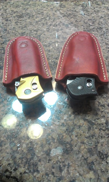

I did these for a fine gentleman Benchmade lover.
Much better than my first one. I'm really liking doing these and next I'm gonna try doing one for my tactical flashlight and multi tool.

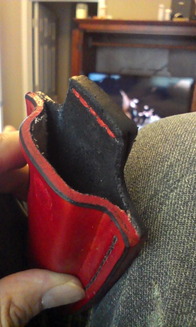

Here's my first little folder sheath. You can see in the pic I made the back go all the way down so there's no ridge. I skived it down to reduce thickness. At the 2" mark from the fold, I've sewn the loop together on top of gluing from that point down. Works well for a pocket sheath or belt. I found that bringing the thread over the end of the top piece and into the back in the beginning stitches keeps the top from wanting to seperate after repeated use.

Nice one Grizz. I like the design a lot.
The customer gave plenty of leash (love that), but did spec a belt loop that was flush with the top, and a specific dimension for his edc belt. I thought about a couple of ways to do the loop, but in the end this made the most sense to me.

The finishing is excellent. I always preferred a separate belt loop sewn onto the back of a sheath or holster. I made a few holsters in the past and used a piece of aluminum bar stock to mold the loop attachment and sewed it to the back before assembly and finishing.

Thanks! Forgot to show the edge, both are the same.
I thought about doing a separate loop because I like them too. Only reason I didn't was to keep the loop at the same level as the top.
