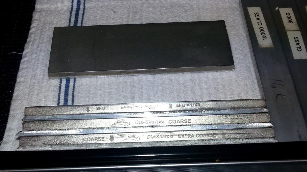

Yes I have. Some folks like to use the 6" x 2" plates on the EP directly. This kind of works, but invariably the plate will fall out of the stone arm. I have gone ahead and mounted my plates on aluminum blanks just as I would a stone. They do work very well too. I cut the aluminum to 6.25 inches then bevel the ends so they will lock in to stone arm. Hopefully you can see it in the picture. ;)
